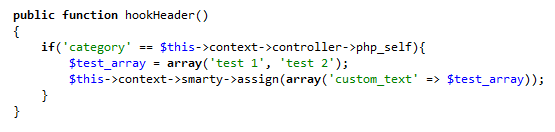

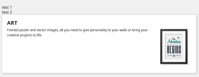

Guest Posted October 13, 2020 Posted October 13, 2020 The problem will be elsewhere. Everything is working. Without your codes, we can only guess where you have a mistake. in module: in tpl: (sample) on category page: Share this post Link to post Share on other sites More sharing options...
ThibaultWUN Posted October 13, 2020 Posted October 13, 2020 Quote The problem will be elsewhere. Everything is working. You answer got me thinking... I made a stupid mistake and my code was is the wrong hook. I saw you screenshot showing the hookHeader and I realised it... I works fine now. Thank you all for your replies ! Share this post Link to post Share on other sites More sharing options...
