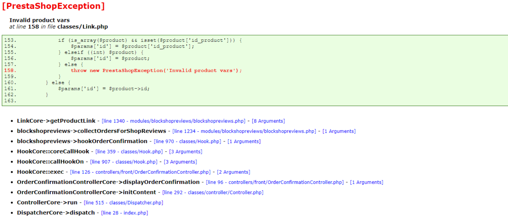

(1/1) UndefinedMethodException
Attempted to call an undefined method named "edit" of class "Razorpay\Api\Collection".
in razorpay.php line 248
at Razorpay->hookOrderConfirmation(array('order' => object(Order), 'cookie' => object(Cookie), 'cart' => object(Cart), 'altern' => 1))in Hook.php line 970
at HookCore::coreCallHook(object(Razorpay), 'hookorderConfirmation', array('order' => object(Order), 'cookie' => object(Cookie), 'cart' => object(Cart), 'altern' => 1))in Hook.php line 359
at HookCore::callHookOn(object(Razorpay), 'displayOrderConfirmation', array('order' => object(Order), 'cookie' => object(Cookie), 'cart' => object(Cart), 'altern' => 1))in Hook.php line 907
at HookCore::exec('displayOrderConfirmation', array('order' => object(Order), 'cookie' => object(Cookie), 'cart' => object(Cart), 'altern' => 1))in OrderConfirmationController.php line 126
at OrderConfirmationControllerCore->displayOrderConfirmation(object(Order))in OrderConfirmationController.php line 96
at OrderConfirmationControllerCore->initContent()in Controller.php line 292
at ControllerCore->run()in Dispatcher.php line 515
at DispatcherCore->dispatch()in index.php line 28

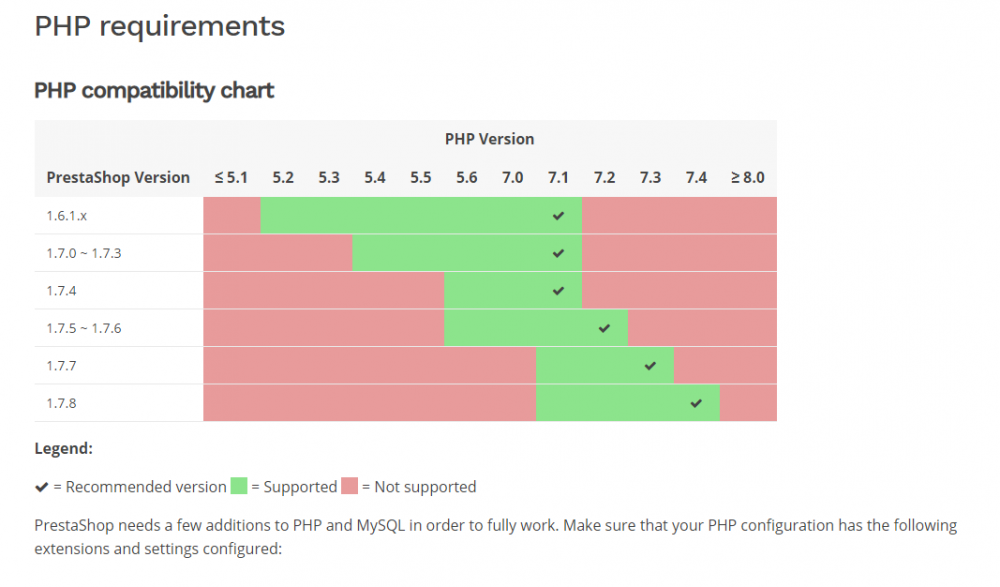

This is really important, Experts PLEASE READ IN FULL!!
Same issue had been reported with CCAvenue payment module from 11th august 2020. Some Customers reported that they got an error page after making an payment, Possibly at the time of redirection after payment processing to site. However none of them had provided the error screen. Also this behavior is inconsistent as whenever we try to make a purchase the order got updated in website, Tried three times different days with different payment methods like Credit Card, Debit Card, Wallets and choosing different shipping methods but every time we order the order got updated successfully in back office!
I contacted gateway CCAvenue but they say everything is fine from them (By the way most stupid customer support these days as they are only available through chat due to Covid-19, no support through call and same is with Bigrock but most of the people from Big Rock are knowledgeable )
Also one thing I am using Bigrock and they had stopped the version of PHP 7.0 and 7.1 from 12th of August and we changed the version of php to 7.3 on 11th of august and thats where all these problems related to payments started.
After that I updated the prestashop from 1.7.6.1 to 1.7.6.7 , updated  modules and theme to the latest version to see if anything will change but no improvement.
So before 5-6 days around 31st august I enabled debug mode in performance tab (Which resulted in the last worst thing that could happen) and after enabling that, errors started showing everywhere in the backoffice and few place in front office and was unable to open performance tab/page again to disable debug option as the error page opens up. After searching a bit on google about the error it was related to the incorrect Composer version installed as the new php version dsn't interpret some tags or escape character as it with older versions. So the suggestion was to upgrade the composer.
Got instructions to update the composer and found that it was not updating and showing error upon installation that permission denied to write at directory. This is because I am on shared hosting and to do so I need to have a root level administrator rights or a Private Server like VPS kind of plan!!
I contacted Bigrock and they denied that they cant update the composer but they figured out the version of PHP which I was earlier using and they said it was 5.6 and they changed it to 5.6 from there side as now in cpanel the only versions for php to select are 7.0/7.1 / 7.2/ 7.3/ 7.4
and just after they changed the php version to 5.6  all the errors are gone and first thing I did was that I disabled the debug mode :D
I had found that the composer versions are compatible with specific php versions only for which they are developed or targeted at and they both needs to be changed else the errors will start firing up wherever there will be any incompatibility in code will happen.
This might be the main reason that we are getting errors now as the php versions are abandoned and forcefully change to 7.3 by default by different hosting providers and bigrock customer support told me that the php 5.6 will stop working soon and they will stop it permanently might be from 31st September.
I request to developers related to Prestashop to help resolve this issue else not thousands lakhs of store owners who are on shared hosting will be badly affected and unable to use their website with Prestashop. Even I am thinking of migrating to Magento even after my love for Prestashop!
Please Help....
Current PrestaShop version support up to PHP 7.2 and PHP 7.2 is still supported until November 2020 https://www.php.net/supported-versions.php
PrestaShop 1.7.7 currently in beta 2 will support PHP 7.3 https://devdocs.prestashop.com/1.7/basics/installation/system-requirements/#php-compatibility-chart
PrestaShop is an open source project, maintenance is made by PrestaShop SA and community, this software cannot evolve quicker if community doesn’t contribute more to the source code. https://devdocs.prestashop.com/1.7/contribute/
More information about PrestaShop 1.7.7 https://build.prestashop.com/news/prestashop-1-7-7-0-beta2-release/
We strongly recommend to test this version on a development environment with your shop to test it and report bugs in order to help us to make the more robust release as possible. https://devdocs.prestashop.com/1.7/contribute/contribute-reporting-issues/
We cannot do everything alone due to limited resources, we need community and if no one contribute we cannot deliver faster.
So please help PrestaShop first and PrestaShop will help you, together we are stronger.
