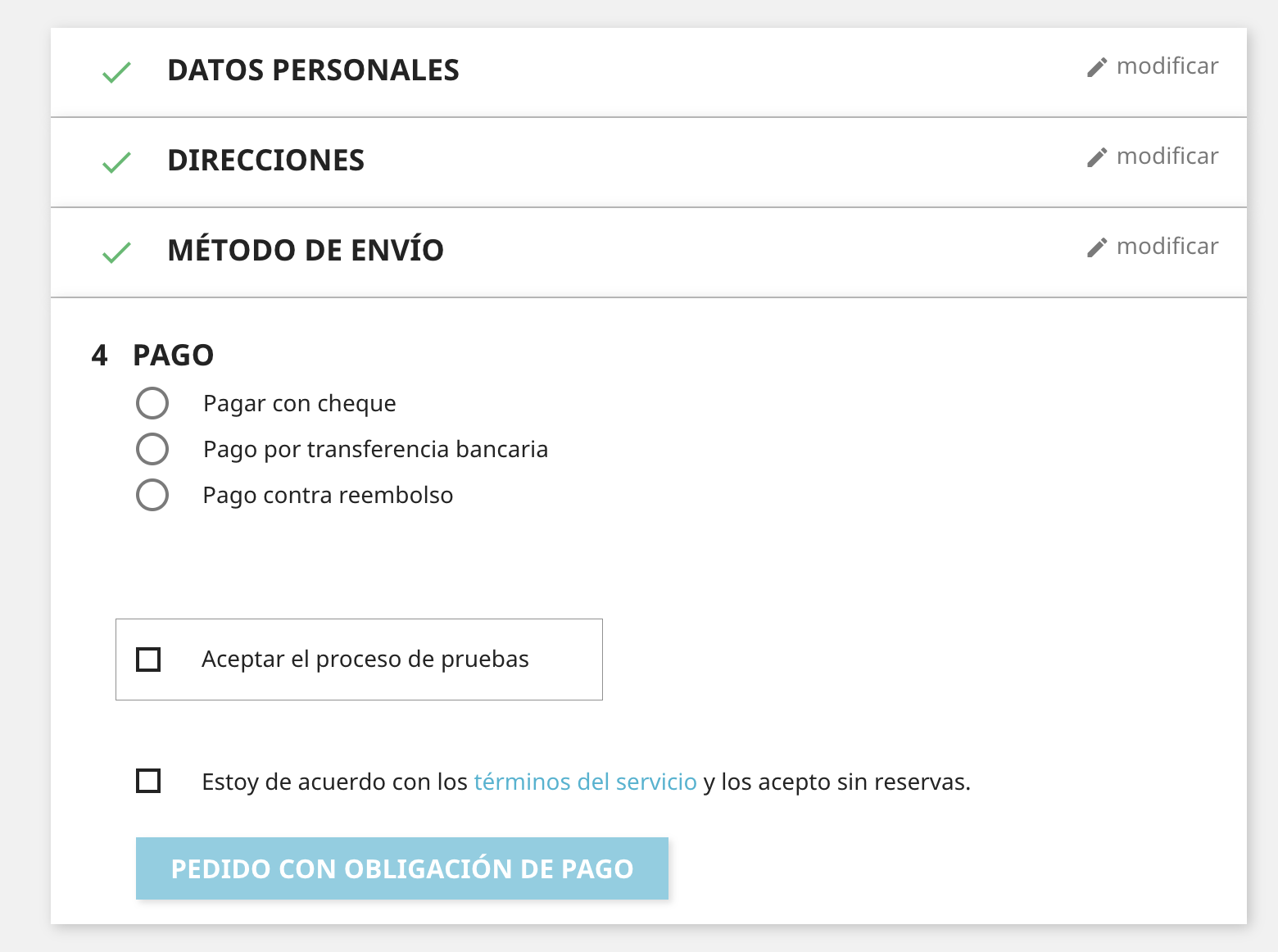

Stiven Gallardo Posted August 16, 2020 Share Posted August 16, 2020 Excuse me for my English. Good evening, could someone help me with something? I want to add a new checkbox in the Payment section in the payment part. I would like to know how to add it and furthermore in which php should I check if the checkbox was selected? Link to comment Share on other sites More sharing options...

Stiven Gallardo Posted August 16, 2020 Author Share Posted August 16, 2020 2 minutes ago, Daresh said: ¿Y qué quieres hacer en esa función, ejecutada en PHP al momento de enviar el formulario? Yes, that a function is executed in the php at the time of submitting the form, for that reason I look for in which php could validate if the checkbox was selected, it is to add the box in the payment section. Yes, that a function is executed in the php at the time of submitting the form, for that reason I look for in which php could validate if the checkbox was selected, it is to add the box in the payment section, something similar as is in the image Link to comment Share on other sites More sharing options...
Daresh Posted August 16, 2020 Share Posted August 16, 2020 But to make sure the checkbox is checked you don't need any additional PHP function to validate it, you just need to place a required checkbox in the form. Prestashop 1.7 has a new hook called TermsAndConditions, to which you can add your own checkboxes with some simple module, and those checkboxes will be required to proceed. I'm attaching you such a module to this post, but it has no configuration, you need to edit it's PHP code to add your own text for the terms. gmterms.zip 1 1 Link to comment Share on other sites More sharing options...
