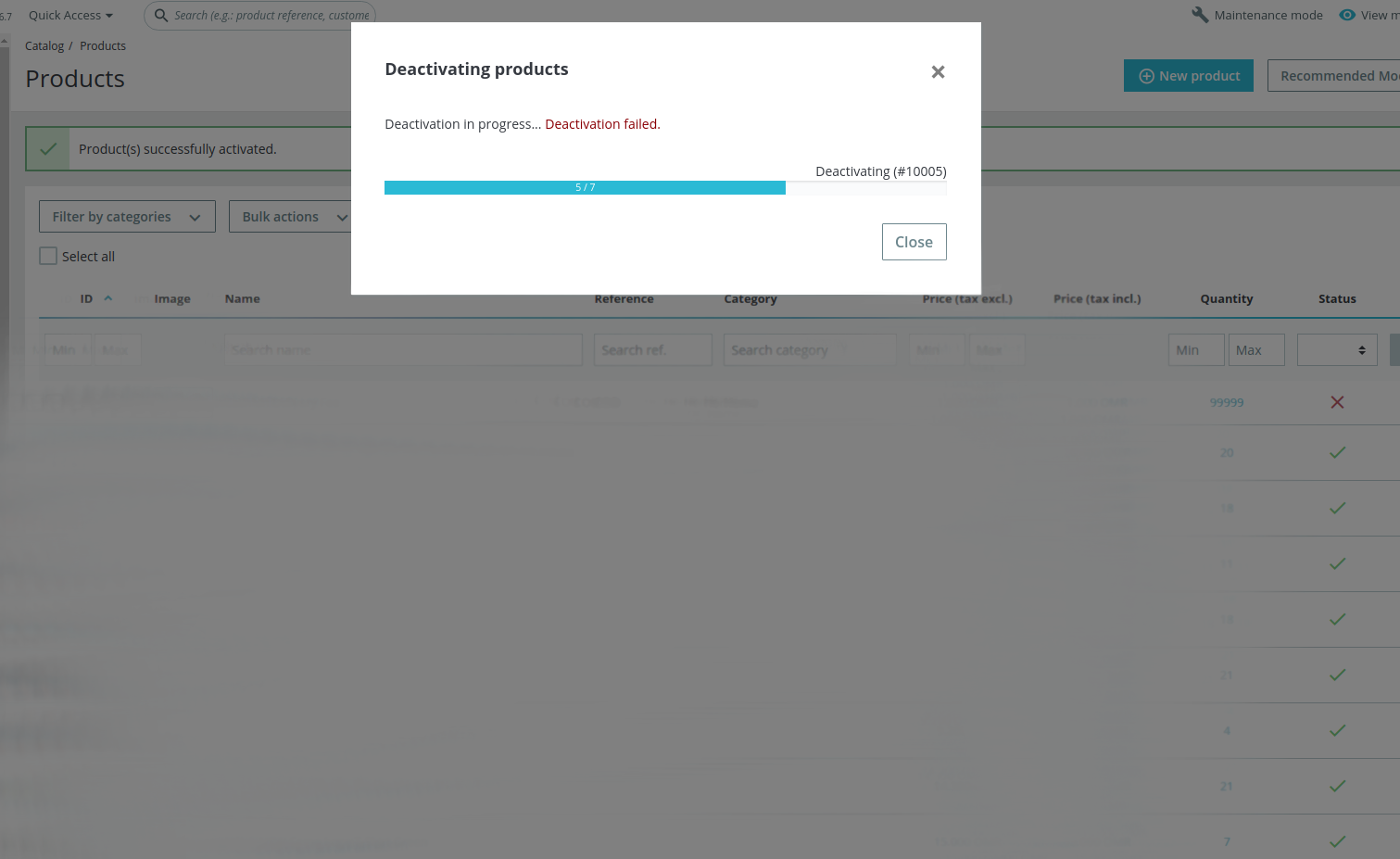

fraizor Posted August 6, 2020 Share Posted August 6, 2020 Hello i'am using 1.7.6.7 i faced a problem from the beginning directly after i installed prestashop, when i tried to delete the sample products i was not able to delete more than 5 products at once the problem still exist on my own products i cant do any bulk action (delete/activate/disable) for more than 5 products, if i tried to do fro 10 products it will stop at 5 and show message attached any ideas ? Link to comment Share on other sites More sharing options...
musicmaster Posted August 6, 2020 Share Posted August 6, 2020 Strange. My guess would be that the processing of the change for the search index is the problem. Have a look at the error log of your server. It might provide a clue. You can also try de-activation of products with Prestools. 1 Link to comment Share on other sites More sharing options...
fraizor Posted August 6, 2020 Author Share Posted August 6, 2020 1 hour ago, musicmaster said: Strange. My guess would be that the processing of the change for the search index is the problem. Have a look at the error log of your server. It might provide a clue. You can also try de-activation of products with Prestools. thanks for fast replay php error log on public_html is empty this is an ajax error ? where can i find these type of errors ? Link to comment Share on other sites More sharing options...

fraizor Posted August 6, 2020 Author Share Posted August 6, 2020 ok after doing lots of troubleshooting and debugging it appeared the problem no from Prestashop it was from the anti DOS module it was limited for 4 requests per second we changed it to 40 , now the problem is gone Link to comment Share on other sites More sharing options...
