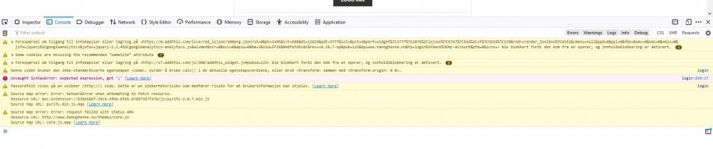

Petter Enge Posted August 3, 2020 Author Share Posted August 3, 2020 When I'm running Inspect Console I got the following : Link to comment Share on other sites More sharing options...
JBW Posted August 4, 2020 Share Posted August 4, 2020 The JS error seems to be caused by module static block and the inserted code here. Try to fix/remove this and see if this resolves the login issue Link to comment Share on other sites More sharing options...

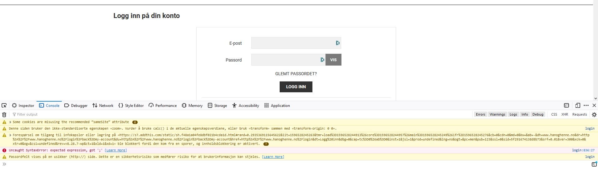

Petter Enge Posted August 4, 2020 Author Share Posted August 4, 2020 Thank you for your reply. I removed the static block module from the server but unfortunaly got the same problem. However when I run the console now I get an interesting message in the console module, as seen on the attached screendump. Its in norwegian so I will translate it. Its the message above the red line: Request for access or saving cookies at «https://s7.addthis.com/static/sh.f48a1a04fe8dbf021b4cda1d.html#rand=0.2935369115645622&iit=1596528245263&tmr=load%3D1596528244913%26core%3D1596528244957%26main%3D1596528245249%26ifr%3D1596528245276&cb=0&cdn=0&md=0&kw=&ab=-&dh=www.hanoghenne.no&dr=http%3A%2F%2Fwww.hanoghenne.no%2Flogin%3Fback%3Dmy-account&du=http%3A%2F%2Fwww.hanoghenne.no%2Flogin%3Fback%3Dmy-account&href=http%3A%2F%2Fwww.hanoghenne.no%2Flogin&dt=Logg%20inn&dbg=0&cap=tc%3D0%26ab%3D0&inst=1&jsl=1&prod=undefined&lng=no&ogt=&pc=men&pub=123&ssl=0&sid=5f291674138d8b73&srf=0.01&ver=300&xck=0&xtr=0&og=&csi=undefined&rev=v8.28.7-wp&ct=1&xld=1&xd=1» was blocked because it came from a tracer and content blocking is activated. What is "s7.addthis.com" ??? I do not yet have SSL on my site, it is ordered but yet not installed. The code was moved from a server with SSL installed so maybe it has something to do with this since the site is called a "tracer" ? Link to comment Share on other sites More sharing options...
Petter Enge Posted August 4, 2020 Author Share Posted August 4, 2020 Problem solved now. My provider has installed the SSL certificate and the problem is gone. It must be some code that was implemented when I had the shop at another server with SSL installed. Thank you anyway. Petter Link to comment Share on other sites More sharing options...
