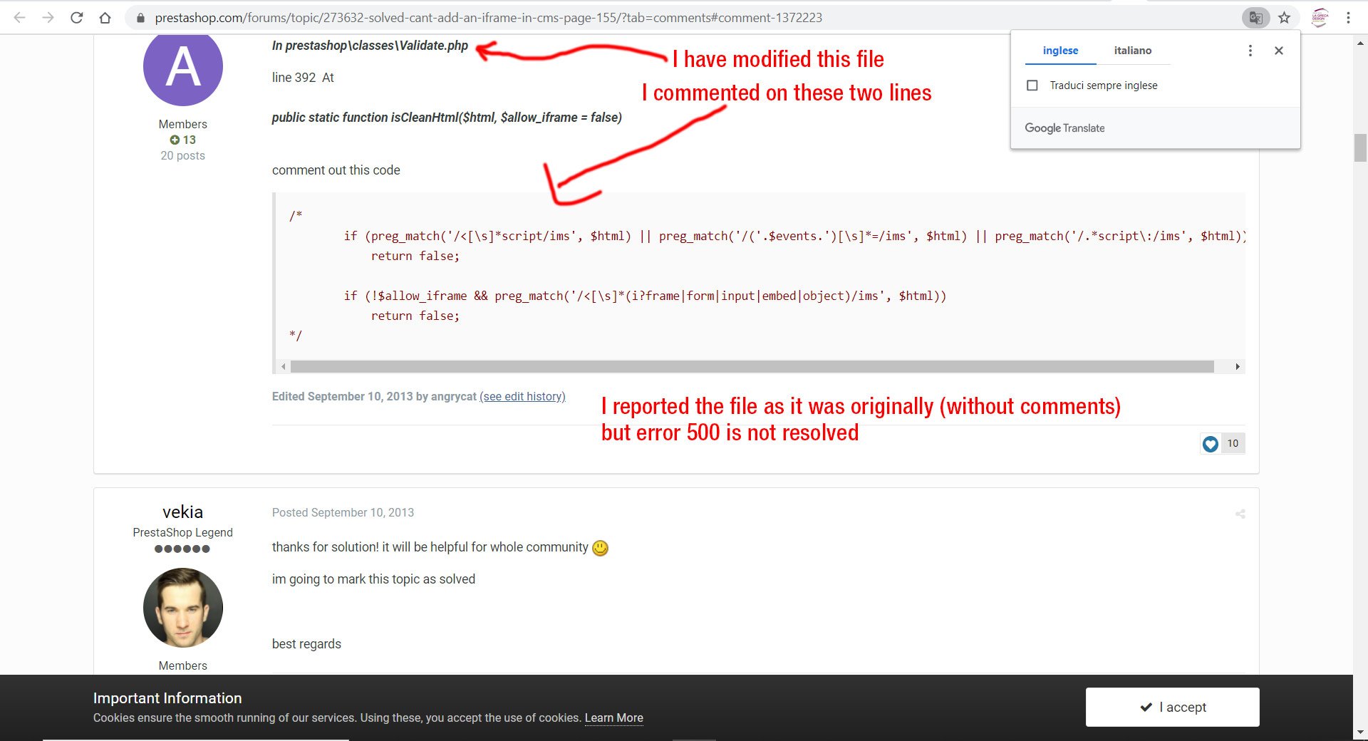

Mastuzza Posted July 30, 2020 Share Posted July 30, 2020 Good morning, i am developing a site in prestashop 1.7.x. I commented a couple of lines in a prestashop file, the file is called validate.php, after the modification I replaced the validate.php file by making a preventive copy first. I'm going to look at the effect of the change and the site, both public and administrative side, is no longer seen providing the http error 500 error I restored the file that I had previously duplicated, but nothing to do the error always occurs. Could you help me solve it? Thank you in advance Regards Maximum Link to comment Share on other sites More sharing options...
