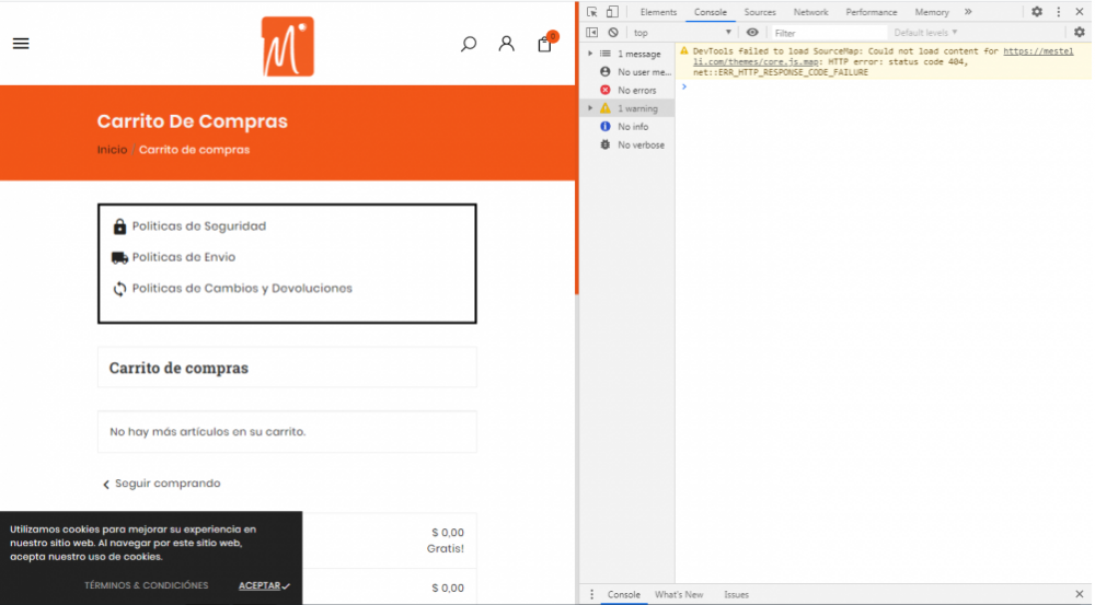

Jeremas Posted July 28, 2020 Share Posted July 28, 2020 (edited) Hay un error 404 de un script: Si bien es de toda la web, no creo que sea bueno. Edited July 28, 2020 by Jeremas Bad Image (see edit history) Link to comment Share on other sites More sharing options...
