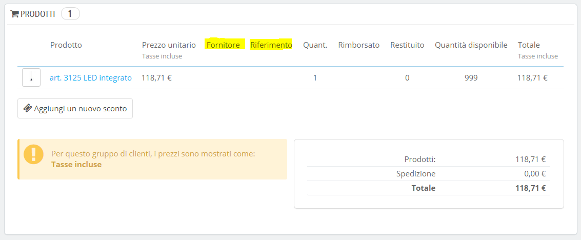

Hello,
I would like to add two columns to the products summary in the order page (in backoffice):
  1. Supplier
  2. Supplier product reference
See attached screenshot for reference. PrestaShop version is 1.7.6.5.
To show  the columns, I added the following code to admin/themes/default/template/controllers/orders/_product_line.php starting at line 75:
<td>
	{if $product.supplier_name}{l s='Reference number:'} {$product.supplier_name}<br />{/if}
</td>
<td>
	{if $product.product_supplier_reference}{l s='Supplier reference:'} {$product.product_supplier_reference}{/if}
</td>
The columns appear in the products summary, but the supplier name and reference code are missing. When I open an order in BO, a notice pops up with error "[8] Undefined index: supplier_name".
I also tried with {Supplier::getnamebyid($id)}, but I don't know how to pass the product's supplier_id.
Any help would be very appreciated! Thank you.

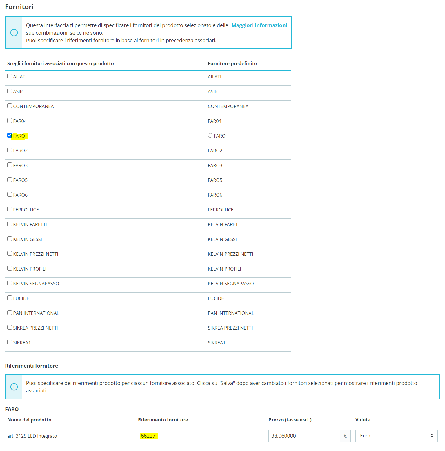

Thank you for your reply. I used the var dump, and it turns out all the relevant variables are empty:
["id_supplier"]=> string(1) "0"
["product_supplier_reference"]=> string(0) ""
["supplier_reference"]=> string(0) ""
even though the supplier parameters are set correctly in the product page.
Screenshot of the Suppliers section for the ordered product.
What can I do to fix this behavior? I already purged cache from BO and by delete the content of var/cache folders.

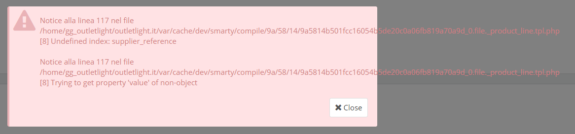

Hi EvaF, thank you for your reply.
I overrode the getProductsDetail function with your code, but the "supplier reference code" column is still empty. I think that the root of the problem is here:
I don't get why product_supplier_reference and supplier_reference are empty. When I open an order, I get the errors "Undefined index" and "Trying to get property 'value' of non-object".

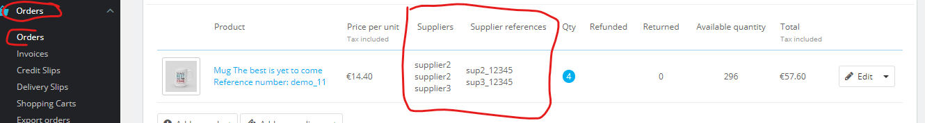

it works for me:
the _product_line.tpl
	<td>{$product['suppliers']}</td>
	<td>{$product['supplier_references']}</td>
	<td class="productQuantity text-center">

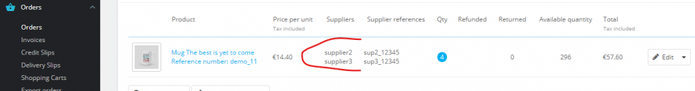

Because default supplier was twice (see picture above), I have changed a little bit query ( and added also product attribute)
    public function getProductsDetail()
        return Db::getInstance(_PS_USE_SQL_SLAVE_)->executeS('
        SELECT od.*, p.*, ps.*,
         concat( ifnull(group_concat(spr.name  SEPARATOR "<BR>" ),"")) as suppliers,
         concat(ifnull(group_concat(psup.product_supplier_reference SEPARATOR "<BR>" ),"")) as supplier_references
        FROM `' . _DB_PREFIX_ . 'order_detail` od
        LEFT JOIN `' . _DB_PREFIX_ . 'product` p ON (p.id_product = od.product_id)
        LEFT JOIN `' . _DB_PREFIX_ . 'product_shop` ps ON (ps.id_product = p.id_product AND ps.id_shop = od.id_shop)
        LEFT JOIN ' . _DB_PREFIX_ . 'product_supplier psup on psup.id_product = p.id_product and od.product_attribute_id =psup.id_product_attribute
        LEFT JOIN ' . _DB_PREFIX_ . 'supplier spr on  spr.id_supplier = psup.id_supplier
        WHERE od.`id_order` = ' . (int) $this->id);
the result:
  • Thanks 2
Hi EvaF.
I was able to get everything to work thanks to your code. I was using a different syntax in my _product_line.tpl (e.g. {$product..supplier_references} instead of {$product['supplier_references']}, which explains the error.
This thread can now be marked as solved.
Thanks again to everyone who participated in the discussion. Cheers!
