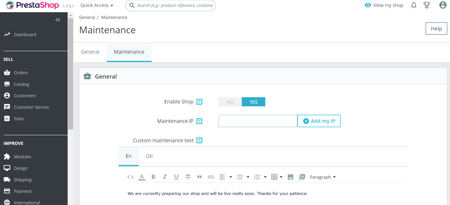

I had a look in Prestashop General Shop Parameters, the Enable Shop option is set to yes. I tried turning it off and on again, no difference.

You should see "maintenance mode" on the top right corner in BO. Click on it and change it to non-maintenance.

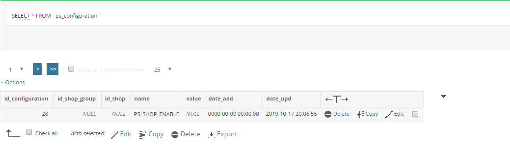

and I found this in the database, do I need to adjust this manually? If so, how do I do that? I'm wary of making my own changes to the db...!
Share this post
Link to post

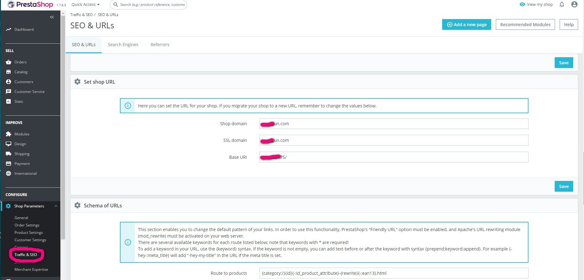

Whereabouts in BO, I don't see that in the top right, am I in the right area? Here's a grab of what I get:
BO means Prestashop Back Office. The screen about is Back office. But, "View my shop" on the top-right corner means your shop is already on production.
Also You are NOT in maintenance mode.
Try clicking the  ""View my shop"  see what happen , you should able to see your shop. Or directly type www.xxx.com...(I tried "http://www.geekyfuroshiki.com" but in maintenance mode)  Let know your BO address (NO password) and I may able to check for you here !
Otherwise,  check in your BO, Shop parameters -> Traffic & SEO -> Set Shop URL (See screen below), Hope this helps !! CheersSEO.thumb.jpg.bdc4dff0122e69854a9ac716997ddef3.jpg

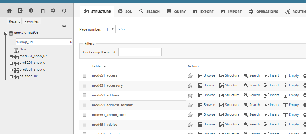

I only have one database in my OVH BO, geekyfurmg909.
I went into that and looked for %_shop_url and found four possible tables, shown in the shot below
ps_ lists the physical_url as '/', and the domain and domain_ssl as www.geekyfuroshiki.com.
pre3201_ lists the physical_url as '/', and the domain and domain_ssl as geekyfuroshiki.com.
mod651_ lists the physical_url as '/[[my username email address]]/', and the domain and domain_ssl as geekyfuroshiki.com.
pre8351_ lists the physical_url as '/geekyfuroshiki.com/shop/', and the domain and domain_ssl as geekyfuroshiki.com.
Based on that, is pre8351 the one I need the password for to put into database_name/ database_user/database_password   in /app/config/parameters.php? Where can I find that password, is it in the database somewhere?
And is there a significance to ps_ having www. in the domain, while the rest don't have it?

Glad...you found it. pre8351_... is the database set for shop. change it to Parameters.php. password should be same as geekyfurmg909, otherwise, you can reset it.
with or without www is your preference only. You shop entry point

I went into /app/config/parameters.php and changed the prefix to pre8351_, then went to the PS BO. Previously it was http://www.geekyfuroshiki.com/admin7032/, with the pre8351_ it becomes http://geekyfuroshiki.com/geekyfuroshiki.com/shop/admin7032/, presumably because it's listed as '/geekyfuroshiki.com/shop/' in the database and is adding an extra 'geekyfuroshiki.com'. Do I need to edit the database entry for pre8351_ to just '/shop'?
Share this post
Link to post
Your BO is http://www.geekyfuroshiki.com/admin7032/, your online shop should be http://www.geekyfuroshiki.com
Database entry (physical_url) should be '/' only.
domain and domain_ssl are www.geekyfuroshiki.com.
p.s. "shop" was your old destination. Your previous reply said you moved to the root.
