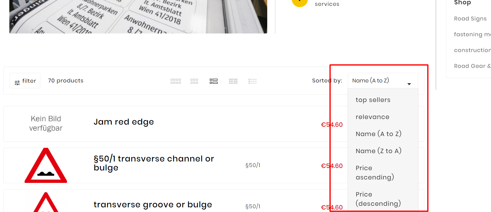

Pragati P Posted April 14, 2023 Share Posted April 14, 2023 Hi , Can anyone help me to find out the file where I get the dropdown values for faceted search. Link to comment Share on other sites More sharing options...
