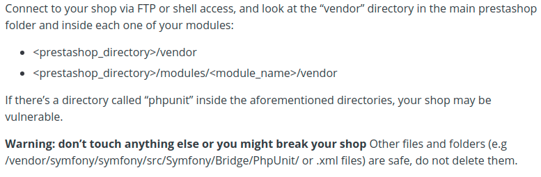

Shops PS 1.5., 1.6. and PS 1.7. are affected from the vulnerability XSAM_XADOO this means vulnerability in phpunit. For to make sure you are save, please delete all the sub-folders /phpunit/ in the folder /modules mentioned below:
Mainly the knowing modules possibly containing a security lack are:
/modules/autoupgrade/vendor/phpunit
/modules/ps_facetedsearch/vendor/phpunit - if exist, as newer module versions do not have this folder.
/modules/gamification/vendor/phpunit - if exist, as newer module versions do not have this folder.
and third development:
/modules/pscartabandonmentpro/vendor/phpunit
/modules/ps_checkout/vendor/phpunit
If you are on root server, then you can clean them via command line:
find . -type d -name "phpunit" -exec rm -rf {} \;
This command requires the relevant user rights.

On 1/6/2020 at 7:26 AM, Masteries said:
Are shops on 1.6 affected? I couldn't find any folder named "PHPUnit" in any of our modules so I presume we're safe?
Yes, if phpunit not found in vulnerable places, it means you are safe
you can find it by running below command at prestashop root
But please follow prestashop instructions and keep your prestashop up to date

You actually don't need to upgrade your version of PHPUnit, it's only used for development & testing purposes by Prestashop/third-party module developers. All you have to do is delete the ones found in any vendor folder. You could also upgrade your Prestashop version to the latest as well if you're worried.
The issue is fixed in PHPUnit 7.5.19 and 8.5.1. So we can presume all versions prior to those are affected.
