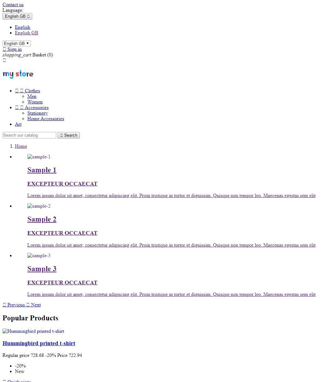

I'm testing WAMP server as I would like to develop my store locally, but first testing how the migration will go to save myself problems in later stages. Unfortunately not everything is working as it should after moving the site to a live environment. The front page and back office have a missing elements front page is all over the place no graphics just text. So definitely I'm doing something wrong.

I forgot to mention this, but I have changed .htaccess file and even deleted it to test. I also cleared all smarty cache before I move my files to my hosting, but still no success.
Every single time I'm trying is the same output.
