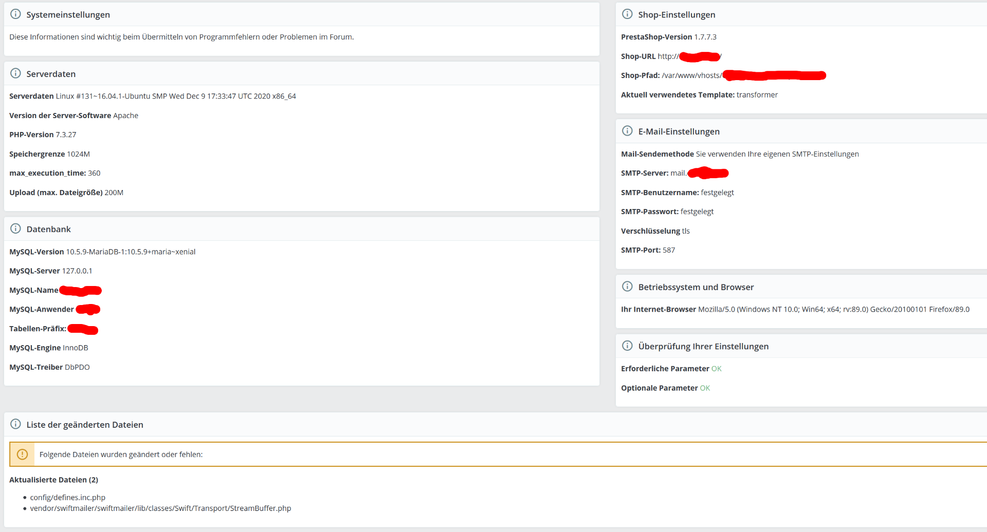

22 minutes ago, V-man said:
I use MySQL-Version 10.5.9-MariaDB-1:10.5.9+maria~xenial
You might be too far with 10
For PC this is requierement.

In my opinion PS ist not very keen on running the highest version but the most stable.
