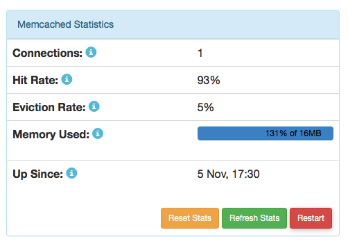

I have memcahed installed on my server and it works good, problem is the allocated memory of 16mb gets consumed very fast above 100% usage.

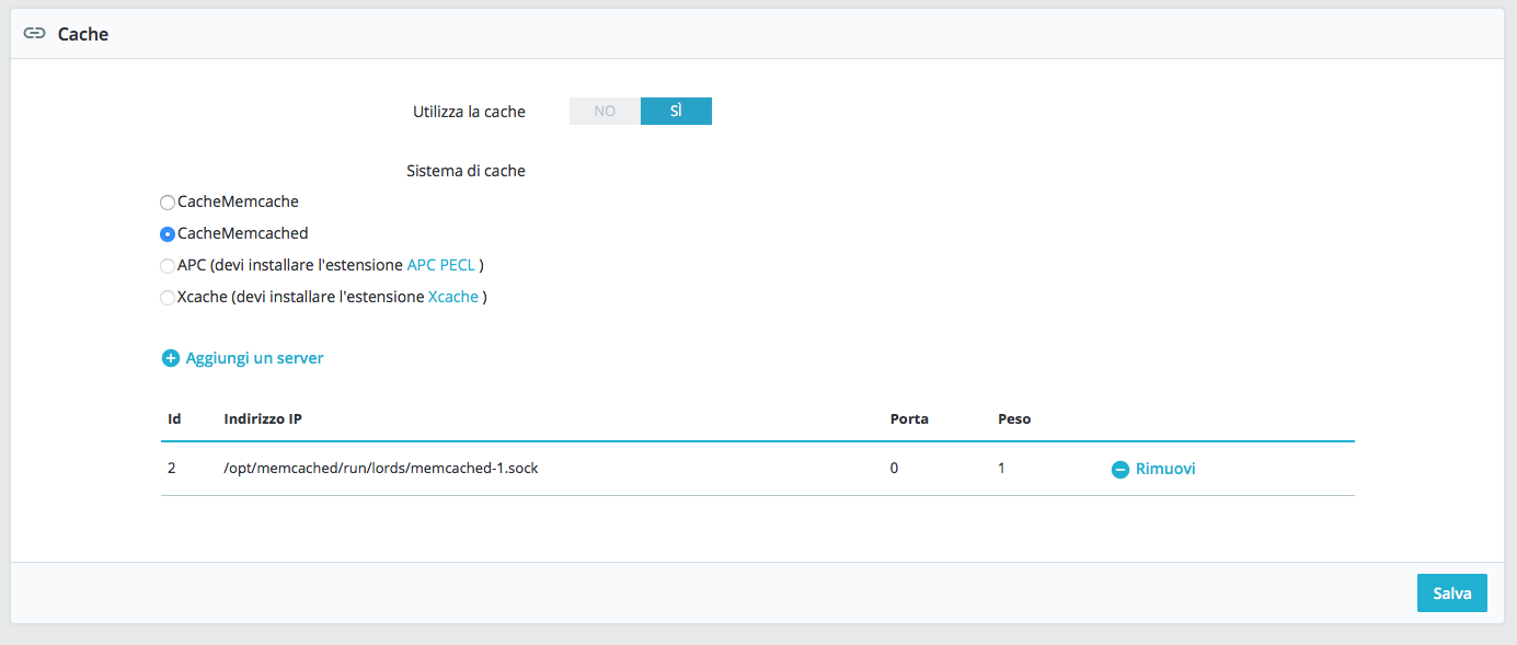

In my advanced parameters the memcache is set up like this:
Id       IP address                                                                              Port      weight
2        /opt/memcached/run/lords/memcached-1.sock            0             1
