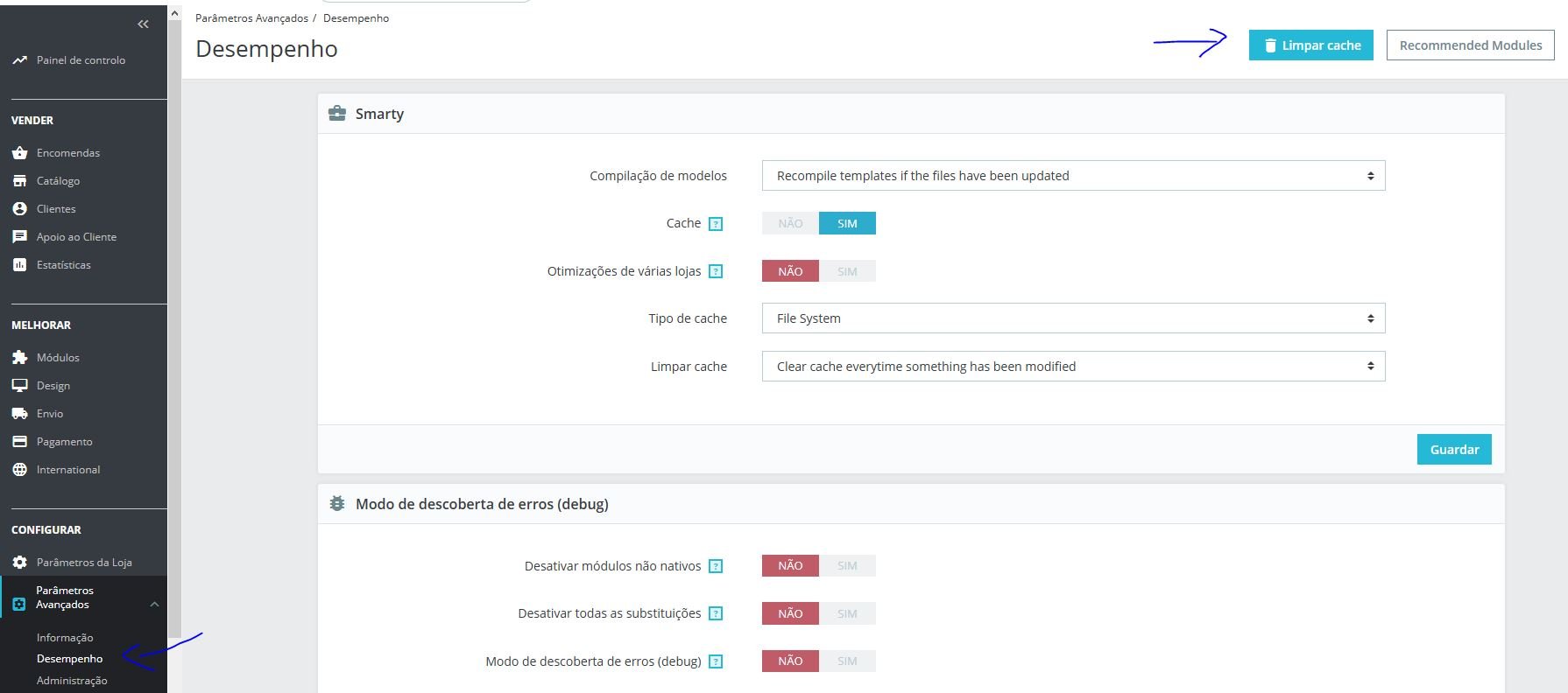

Clear the shops cache...
And if that doesn´t do it, delete /var/cache/prod/* using FTP cliente...
Best regards

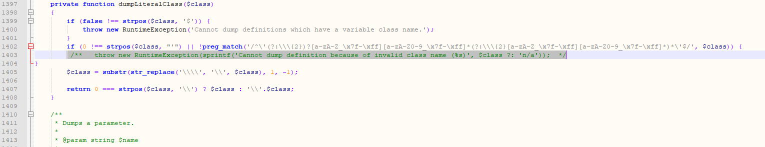

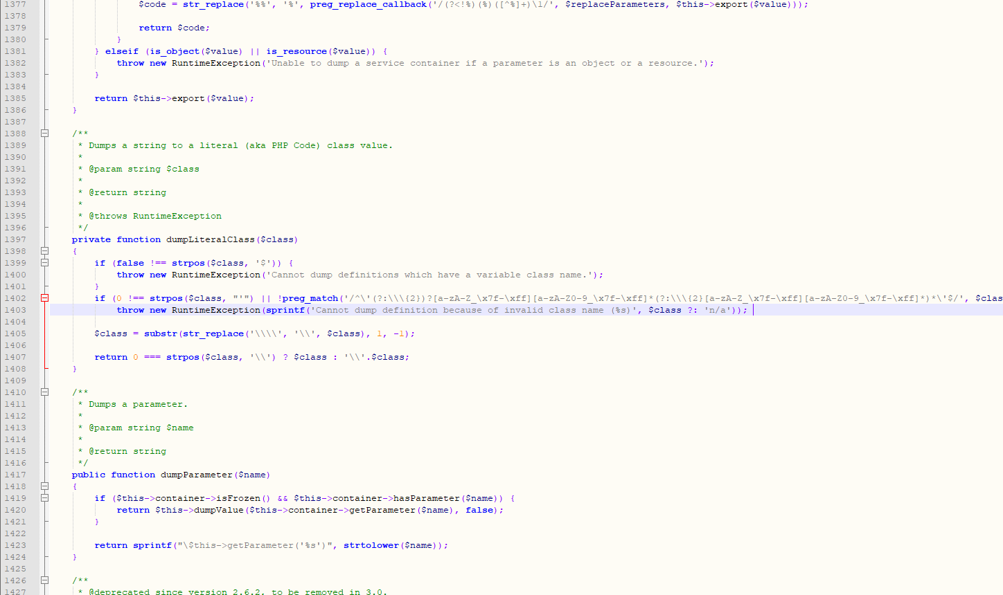

Sorry i forgot you have already done that :) try to comment the line it mentions 1403, or even rename phpdumper.php...

40 minutes ago, friweb99 said:
I'd comment line 1403 and everything works!!!!
You saved my life
Could I will have problems without this line?
Thx a lot

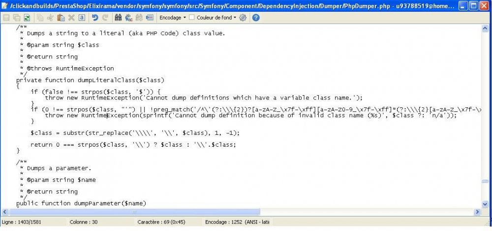

3 hours ago, Armando027160 said:
Thank you for your return, but I'm a bit nil and do not understand what to register and where? here is my 1403 php line. If you could be a little more precise it would be nice.
If you don´t know what you are doing, it´s better not do it, you might do more arm than good!!!
Lets say you want to coment out the line that says "return 0 === strpos($class, '\\')…" you would do this "/* return 0 === strpos($class, '\\')… */"
If for instance it´s na if statemente you have to comment the all block.
Note: by your exxample i don´t know whitch one is line 1403!
