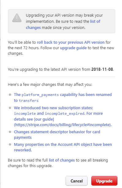

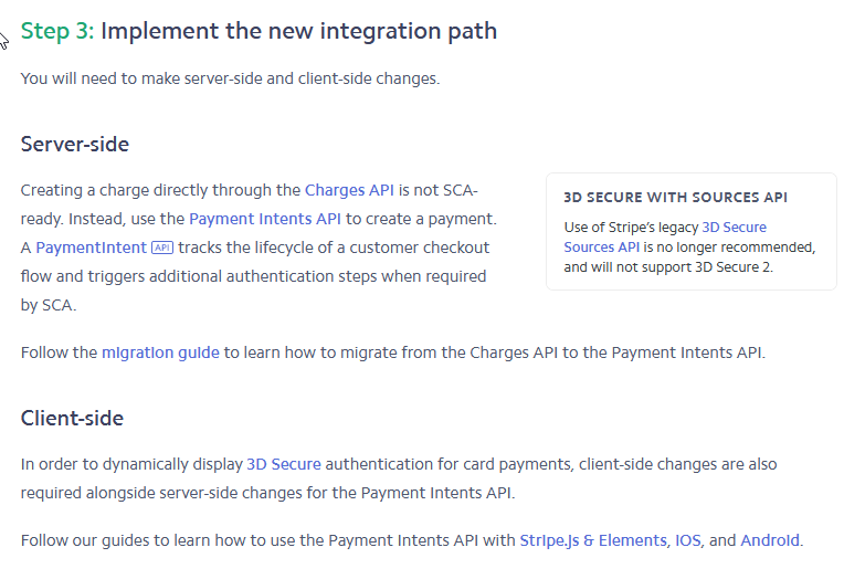

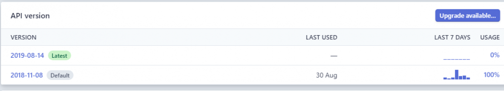

Personally, I can't be sure, but I'm thinking that those instructions may be for manually coded processing, as in someone physically coding the API's into their own website to accept payments, rather than us using the Stripe Module - from my Stripe dashboard it's showing that the Prestashop module is SCA Ready and I should upgrade.   I could be wrong, but I'm seeing nothing in the way of having to generate anything other than the API keys we're using, my understanding is the module does the work for SCA but I'll take another look just in case :)
Seems you could be right actually, in the Developers dashboard I see an "upgrade available" button as follows ...
Clicking it gives the following ....
If this is so critical to the latest module, why wouldn't this be a part of the upgrade instructions or at least highlighted somewhere, unless I've totally missed it!!.   I'll do this tomorrow, as it is possible to roll back if all goes belly up and install the new module again and see what happens!
OK, tried the various upgrades, etc, still not working with the latest version of the module.
