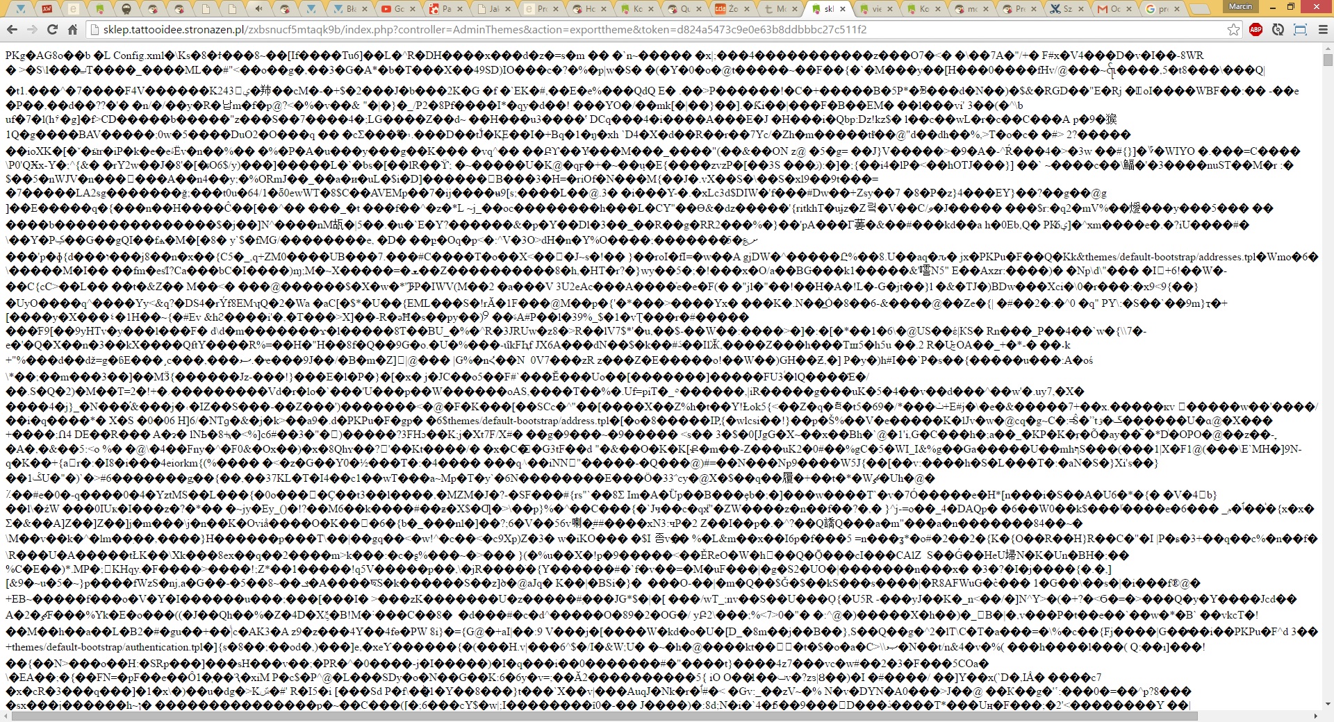

Błąd przy eksporcie edytowanego szablonu
Marcin.Kwiecien replied to Marcin.Kwiecien's question in Wsparcie i pomoc użytkowników
Piki zip niby idą jako download. Przy pomocy supportu dowiedziałem się, że wywala mi następujące błędy: Warning: Cannot modify header information - headers already sent by (output started at /home/tattooid/domains/tattooidee.stronazen.pl/public_html/sklep/themes/default-bootstrap/modules/blockcontact/translations/pl.php:1) in /home/tattooid/domains/tattooidee.stronazen.pl/public_html/sklep/controllers/admin/AdminThemesController.php on line 906 Warning: Cannot modify header information - headers already sent by (output started at /home/tattooid/domains/tattooidee.stronazen.pl/public_html/sklep/themes/default-bootstrap/modules/blockcontact/translations/pl.php:1) in /home/tattooid/domains/tattooidee.stronazen.pl/public_html/sklep/controllers/admin/AdminThemesController.php on line 907 Warning: Cannot modify header information - headers already sent by (output started at /home/tattooid/domains/tattooidee.stronazen.pl/public_html/sklep/themes/default-bootstrap/modules/blockcontact/translations/pl.php:1) in /home/tattooid/domains/tattooidee.stronazen.pl/public_html/sklep/controllers/admin/AdminThemesController.php on line 908 Warning: Cannot modify header information - headers already sent by (output started at /home/tattooid/domains/tattooidee.stronazen.pl/public_html/sklep/themes/default-bootstrap/modules/blockcontact/translations/pl.php:1) in /home/tattooid/domains/tattooidee.stronazen.pl/public_html/sklep/controllers/admin/AdminThemesController.php on line 909 Warning: Cannot modify header information - headers already sent by (output started at /home/tattooid/domains/tattooidee.stronazen.pl/public_html/sklep/themes/default-bootstrap/modules/blockcontact/translations/pl.php:1) in /home/tattooid/domains/tattooidee.stronazen.pl/public_html/sklep/controllers/admin/AdminThemesController.php on line 910 Warning: Cannot modify header information - headers already sent by (output started at /home/tattooid/domains/tattooidee.stronazen.pl/public_html/sklep/themes/default-bootstrap/modules/blockcontact/translations/pl.php:1) in /home/tattooid/domains/tattooidee.stronazen.pl/public_html/sklep/controllers/admin/AdminThemesController.php on line 911 Warning: Cannot modify header information - headers already sent by (output started at /home/tattooid/domains/tattooidee.stronazen.pl/public_html/sklep/themes/default-bootstrap/modules/blockcontact/translations/pl.php:1) in /home/tattooid/domains/tattooidee.stronazen.pl/public_html/sklep/controllers/admin/AdminThemesController.php on line 912 Warning: Cannot modify header information - headers already sent by (output started at /home/tattooid/domains/tattooidee.stronazen.pl/public_html/sklep/themes/default-bootstrap/modules/blockcontact/translations/pl.php:1) in /home/tattooid/domains/tattooidee.stronazen.pl/public_html/sklep/controllers/admin/AdminThemesController.php on line 913 Zaraz spróbuję usunąć pliki modułu blockcontact z szablonu i zobaczę co się stanie Edit: Niestety, nie pomogło. Edit2: Pomogło. Wcześniej przez pomyłkę usunąłem blockcontact z sklep/modules, zamiast z szablonu. -
Marcin.Kwiecien posted a question in Wsparcie i pomoc użytkowników
Hej, zainstalowałem czystą prestę 1.6.1.0 i na niej edytowałem domyślny szablon. Gdy osiągnąłem pożądany efekt, chciałem go eksportować i wrzucić na właściwy sklep. Problem w tym, że korzystając z eksportu szablonów, już po ustawieniu nazwy itp. oraz kliknięciu "zapisz", otrzymuję coś takiego jak w załączniku. Nie potrafię rozszyfrować powodu. Ktoś ma jakiś pomysł, jaka może być przyczyna i (najlepiej) rozwiązanie? -
