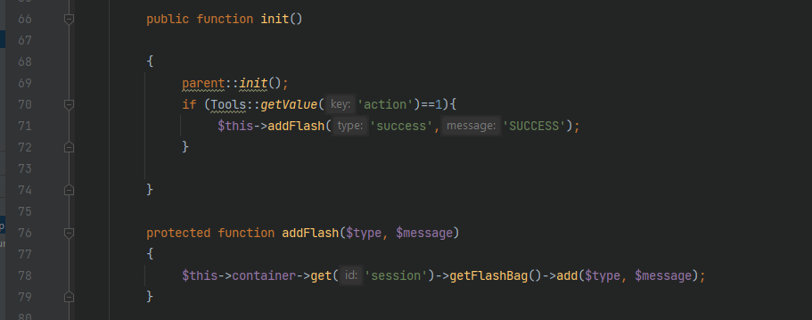

Hello! I am trying to create a module for the admin section, and i am trying to figure out come stuff. The public function init() is loaded automatically? or do i stiil have to autoexecute it using the parent:init() ? the following code does not work... and i do not understand why. Does it have to do with the getFlashBag method? in order to trigger this code i put a link which has the href: ?controller=AdminDashboard&action=1" with and without token.

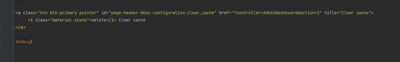

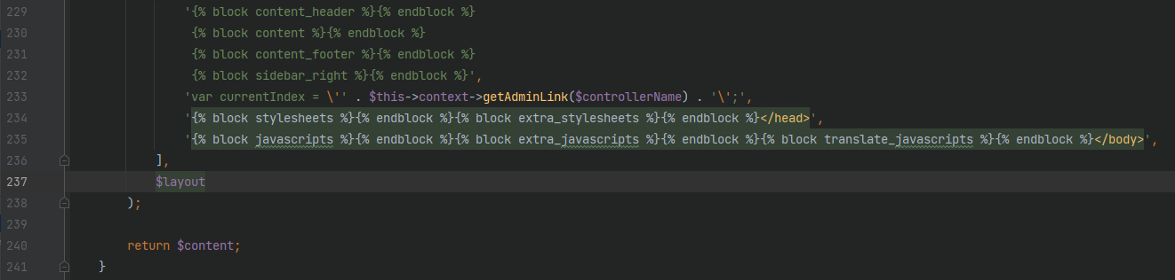

Hello! I have the following problem. When i put in a tpl the smarty debug using: {debug} i get the following error: Type error: Argument 1 passed to PrestaShopBundle\Twig\LayoutExtension::escapeSmarty() must be of the type string, null given, called in /home........public_html/prestadef/src/PrestaShopBundle/Twig/LayoutExtension.php on line 234 which is: my tpl is simply : The problem goes away if i remove the debug.
