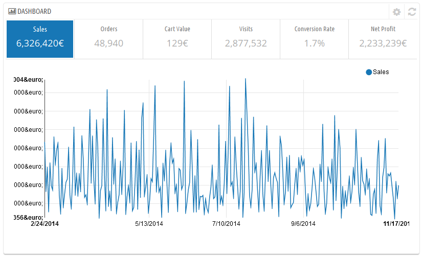

Hi, sorry for the delay. I fixed my issue, it was the configuration of the Currencies, where I had € instead of the correct symbol. Even the US Dollar currency was wrongly configured. I guess (hope) the issue was with the 1st installation using PS 1.6.0.6 or with an upgrade (I used all the upgrade steps from 1.6.0.6 to the current 1.6.0.9). I copied the currency configuration for both from a test shop I have on the PrestaShop beta program and now looks fine. Thanks anyway.
Hello all, On my installation, the euro values in the dashboard chart is showing as € instead of the euro symbol € (check the screenshot in attach) in the vertical axis. Due to this, there is no space left on the left of the chart to show the complete value. I'm wondering if this is a bug or it's a configuration somewhere? Any help?
