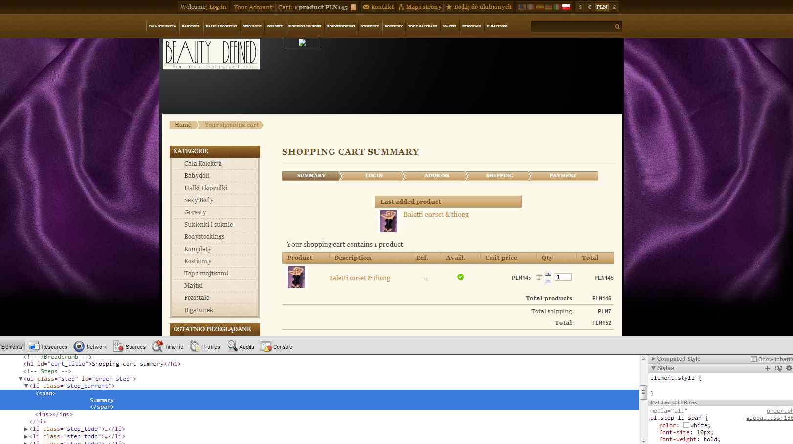

I have same translation in shopping cart as france germany etc. Theres no lines of most of the lines from BO, they must be somewhere else. example translation in general modules/blockcart/FR.php "<?php global $_MODULE; $_MODULE = array(); $_MODULE['<{blockcart}prestashop>blockcart_c2e1362a9710a3dd86f937c2ea1f336d'] = 'Bloc panier'; $_MODULE['<{blockcart}prestashop>blockcart_e03093a5753b436ee1de63b6e3e1bd02'] = 'Ajoute un bloc avec le contenu du panier du client'; $_MODULE['<{blockcart}prestashop>blockcart_eb4ae207521bbe6403f7fe9564d38cda'] = 'Ajax : choix invalide.'; $_MODULE['<{blockcart}prestashop>blockcart_f4d1ea475eaa85102e2b4e6d95da84bd'] = 'Confirmation'; $_MODULE['<{blockcart}prestashop>blockcart_c888438d14855d7d96a2724ee9c306bd'] = 'Paramètres mis à jour'; $_MODULE['<{blockcart}prestashop>blockcart_f4f70727dc34561dfde1a3c529b6205c'] = 'Paramètres'; $_MODULE['<{blockcart}prestashop>blockcart_614a8820aa4ac08ce2ee398a41b10778'] = 'Panier AJAX'; $_MODULE['<{blockcart}prestashop>blockcart_00d23a76e43b46dae9ec7aa9dcbebb32'] = 'Activé'; $_MODULE['<{blockcart}prestashop>blockcart_b9f5c797ebbf55adccdd8539a65a0241'] = 'Désactivé'; $_MODULE['<{blockcart}prestashop>blockcart_dba281afb9a38e654ea9dab4cd6cb0ca'] = 'Activer le mode AJAX du panier (compatible avec le thème par défaut)'; $_MODULE['<{blockcart}prestashop>blockcart_c9cc8cce247e49bae79f15173ce97354'] = 'Enregistrer'; $_MODULE['<{blockcart}prestashop>blockcart_20351b3328c35ab617549920f5cb4939'] = 'Personnalisation '; $_MODULE['<{blockcart}prestashop>blockcart_ed6e9a09a111035684bb23682561e12d'] = 'supprimer cet article du panier'; $_MODULE['<{blockcart}prestashop>blockcart_a85eba4c6c699122b2bb1387ea4813ad'] = 'Panier'; $_MODULE['<{blockcart}prestashop>blockcart_86024cad1e83101d97359d7351051156'] = 'articles'; $_MODULE['<{blockcart}prestashop>blockcart_f5bf48aa40cad7891eb709fcf1fde128'] = 'article'; $_MODULE['<{blockcart}prestashop>blockcart_9e65b51e82f2a9b9f72ebe3e083582bb'] = '(vide)'; $_MODULE['<{blockcart}prestashop>blockcart_4b7d496eedb665d0b5f589f2f874e7cb'] = 'Détails de l\'article'; $_MODULE['<{blockcart}prestashop>blockcart_853ae90f0351324bd73ea615e6487517'] = ' :'; $_MODULE['<{blockcart}prestashop>blockcart_09dc02ecbb078868a3a86dded030076d'] = 'Aucun produit'; $_MODULE['<{blockcart}prestashop>blockcart_f2a6c498fb90ee345d997f888fce3b18'] = 'Supprimer'; $_MODULE['<{blockcart}prestashop>blockcart_ea9cf7e47ff33b2be14e6dd07cbcefc6'] = 'Expédition'; $_MODULE['<{blockcart}prestashop>blockcart_ba794350deb07c0c96fe73bd12239059'] = 'Emballage'; $_MODULE['<{blockcart}prestashop>blockcart_4b78ac8eb158840e9638a3aeb26c4a9d'] = 'Taxes'; $_MODULE['<{blockcart}prestashop>blockcart_96b0141273eabab320119c467cdcaf17'] = 'Total'; $_MODULE['<{blockcart}prestashop>blockcart_0d11c2b75cf03522c8d97938490466b2'] = 'Les prix sont TTC'; $_MODULE['<{blockcart}prestashop>blockcart_41202aa6b8cf7ae885644717dab1e8b4'] = 'Les prix sont HT'; $_MODULE['<{blockcart}prestashop>blockcart_377e99e7404b414341a9621f7fb3f906'] = 'Commander'; " general modules/blockcart/pl.php <?php global $_MODULE; $_MODULE = array(); $_MODULE['<{blockcart}prestashop>blockcart_c2e1362a9710a3dd86f937c2ea1f336d'] = 'Blok koszyka'; $_MODULE['<{blockcart}prestashop>blockcart_e03093a5753b436ee1de63b6e3e1bd02'] = 'Dodaj blok zawierający koszyk klienta.'; $_MODULE['<{blockcart}prestashop>blockcart_eb4ae207521bbe6403f7fe9564d38cda'] = 'Ajax: Nieprawidłowy wybór.'; $_MODULE['<{blockcart}prestashop>blockcart_f4d1ea475eaa85102e2b4e6d95da84bd'] = 'Potwierdzenie'; $_MODULE['<{blockcart}prestashop>blockcart_c888438d14855d7d96a2724ee9c306bd'] = 'Zaktualizowano'; $_MODULE['<{blockcart}prestashop>blockcart_f4f70727dc34561dfde1a3c529b6205c'] = 'Ustawienia'; $_MODULE['<{blockcart}prestashop>blockcart_614a8820aa4ac08ce2ee398a41b10778'] = 'Koszyk Ajax'; $_MODULE['<{blockcart}prestashop>blockcart_00d23a76e43b46dae9ec7aa9dcbebb32'] = 'Włączony'; $_MODULE['<{blockcart}prestashop>blockcart_b9f5c797ebbf55adccdd8539a65a0241'] = 'Wyłączony'; $_MODULE['<{blockcart}prestashop>blockcart_dba281afb9a38e654ea9dab4cd6cb0ca'] = 'Aktywuj tryb AJAX dla koszyka (kompatybilne ze standardową skórką)'; $_MODULE['<{blockcart}prestashop>blockcart_c9cc8cce247e49bae79f15173ce97354'] = 'Zapisz'; $_MODULE['<{blockcart}prestashop>blockcart_20351b3328c35ab617549920f5cb4939'] = 'Dostosowanie #'; $_MODULE['<{blockcart}prestashop>blockcart_ed6e9a09a111035684bb23682561e12d'] = 'usuń produkt z koszyka'; $_MODULE['<{blockcart}prestashop>blockcart_a85eba4c6c699122b2bb1387ea4813ad'] = 'Koszyk'; $_MODULE['<{blockcart}prestashop>blockcart_86024cad1e83101d97359d7351051156'] = 'produkty'; $_MODULE['<{blockcart}prestashop>blockcart_f5bf48aa40cad7891eb709fcf1fde128'] = 'produkt'; $_MODULE['<{blockcart}prestashop>blockcart_9e65b51e82f2a9b9f72ebe3e083582bb'] = 'jest pusty'; $_MODULE['<{blockcart}prestashop>blockcart_4b7d496eedb665d0b5f589f2f874e7cb'] = 'Szczegóły produktu'; $_MODULE['<{blockcart}prestashop>blockcart_853ae90f0351324bd73ea615e6487517'] = ':'; $_MODULE['<{blockcart}prestashop>blockcart_09dc02ecbb078868a3a86dded030076d'] = 'Brak produktów'; $_MODULE['<{blockcart}prestashop>blockcart_f2a6c498fb90ee345d997f888fce3b18'] = 'Usuń'; $_MODULE['<{blockcart}prestashop>blockcart_ea9cf7e47ff33b2be14e6dd07cbcefc6'] = 'Dostawa'; $_MODULE['<{blockcart}prestashop>blockcart_ba794350deb07c0c96fe73bd12239059'] = 'Opakowanie'; $_MODULE['<{blockcart}prestashop>blockcart_4b78ac8eb158840e9638a3aeb26c4a9d'] = 'Podatek'; $_MODULE['<{blockcart}prestashop>blockcart_96b0141273eabab320119c467cdcaf17'] = 'Suma'; $_MODULE['<{blockcart}prestashop>blockcart_0d11c2b75cf03522c8d97938490466b2'] = 'Podane ceny są cenami brutto'; $_MODULE['<{blockcart}prestashop>blockcart_41202aa6b8cf7ae885644717dab1e8b4'] = 'Podane ceny są cenami netto'; $_MODULE['<{blockcart}prestashop>blockcart_377e99e7404b414341a9621f7fb3f906'] = 'Realizuj zamówienie'; -

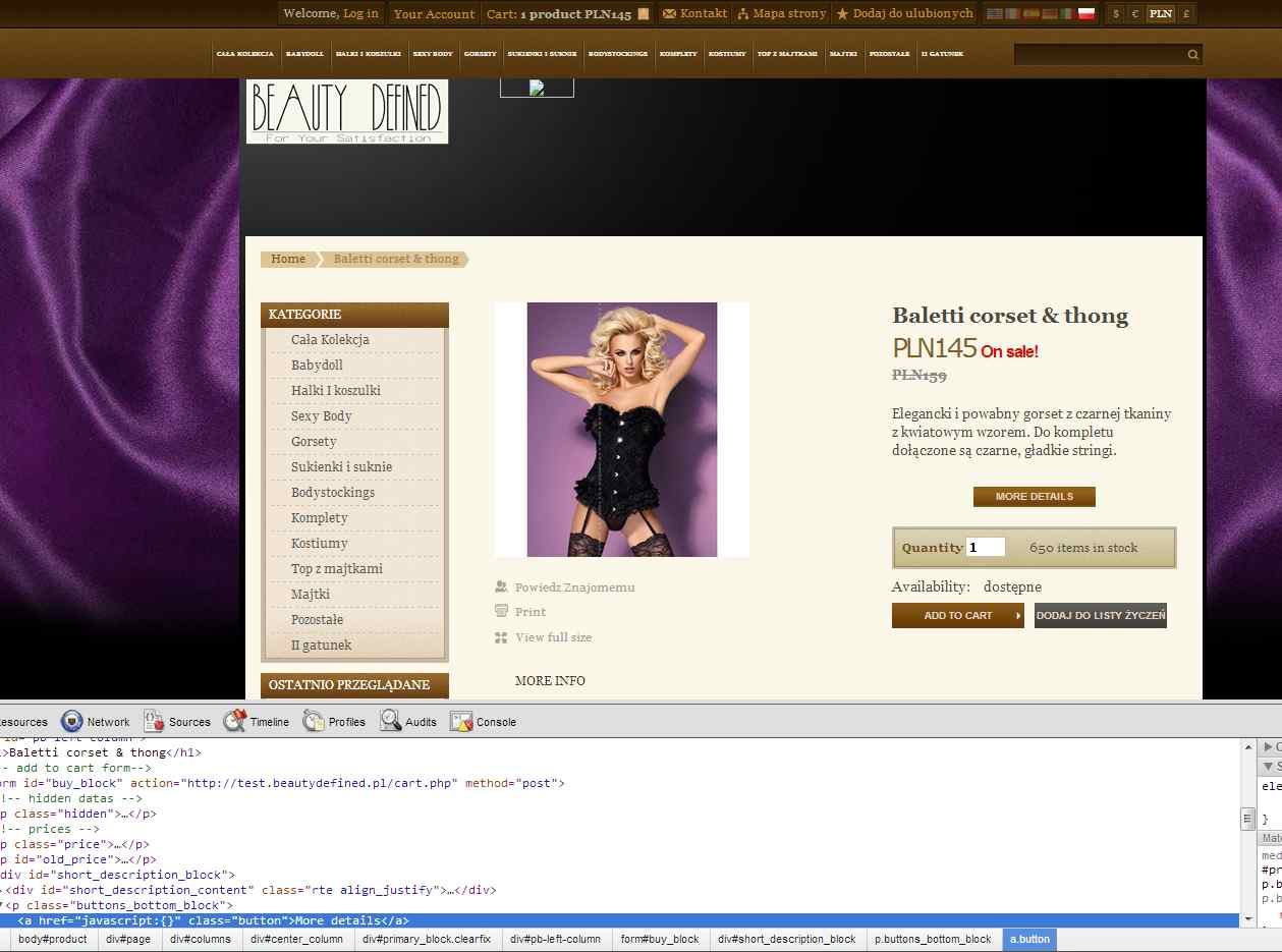

Hi, I probably post it in bad forum. Im sorry for that, I'm newbie (in rush) here I'm using 1.4.8.2 PS I have problem with Polsig translation that I add. The translation is fill, I can see it in BO tools/translations/front office translation Default Language is set to Polish Modules are mostly translated. I translate modules that are active also manually. But most of the page input English not Polish. I wanna add 4 more languages also and I probably will have the same situations http://test.beautyde...hp?id_product=1 I attached screens. I'll be glad for help.
