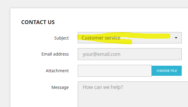

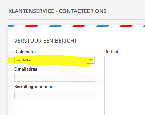

I have 2 shops: one is on PS 1.6.1.24 and when I look at the contact form it shows -- choose -- as a default subject (email to). This webshop does not have any problem with spam use of the contact form. The other shop is on PS 1.7.2.4 and with this contact form it has no the -- choose -- as a default anymore. This webshop has daily 20-30 spam emails using the contact form because the default "subject" setting is one of the addresses set (customer service) in the back office shop in settings>contact. How do I get this --choose-- setting used in PS 1.6 to the shop 1.7. Now I have deleted all email address and added a default text in de message body saying people can only send a message using our email address and not the contact form just to stop the spam emails. Why was this functional layout in 1.6 taken out of 1.7 ? It was an easy way to prevent spam.
- 1 reply
- contact form 1.7
- contact form edit

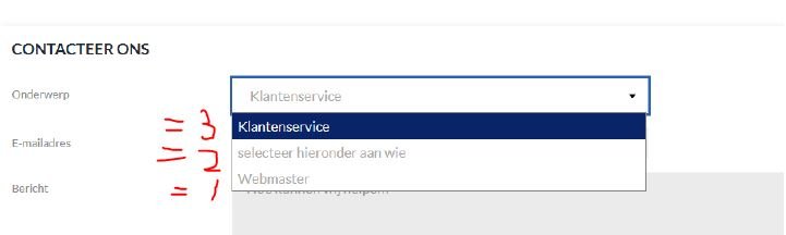

I have a problem with spam received/sent through contact form. I remember in the olders version (1.4 if I remember correctly) that a simple solution was to create a blanc contact in the paramaters>contact list and have this shown in the drop down list as #1. Now I have PS 1.7 and the contact form is sorted in a random way and nothing like the contact in the parameters. How (and where) do I change the contact form code so that it copies the exact rang order of the set parameters?
- 1 reply
- contact form 1.7
- contact form edit
(and 2 more)

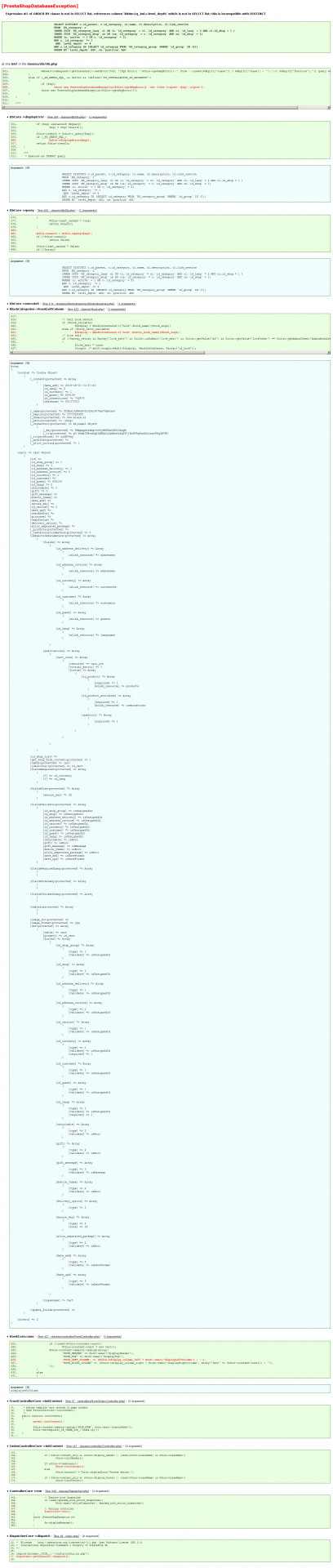

Hallo Ik have done en update of PHP and MySGL versions and now the front office appears to work but no products are shown. Also the back office vieuw is normal but when you click on orders or products the wrror appears When I put debug on I get: PrestaShopDatabaseException] Expression #1 of ORDER BY clause is not in SELECT list, references column 'xxxxxx_knl.c.level_depth' which is not in SELECT list; this is incompatible with DISTINCT I enclose the complete error message Webshop is running on PS version 1.5.4.1 MySQL was 5.5.62 now 5.7.27 What can this be? Thanks for your help !
Hallo Ik heb een update gedaan van PHP en MySQL en nu werkt de frontoffice en de backoffice op het eerste gezicht wel maar er worden in de frontoffice geen producten meer getoond. Ook de back office overzichten zien er normaal uit maar als je verder klikt op een order of products krijg je weer de foutmedling. Als is debug aanzet staat er: [PrestaShopDatabaseException] Expression #1 of ORDER BY clause is not in SELECT list, references column 'xxxxxx_knl.c.level_depth' which is not in SELECT list; this is incompatible with DISTINCT Volledig error message sluit ik bij. Webshop draait nog op 1.5.4.1 MySQL was 5.5.62 nu 5.7.27 Wat kan dit zijn?
