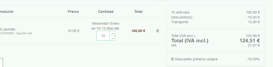

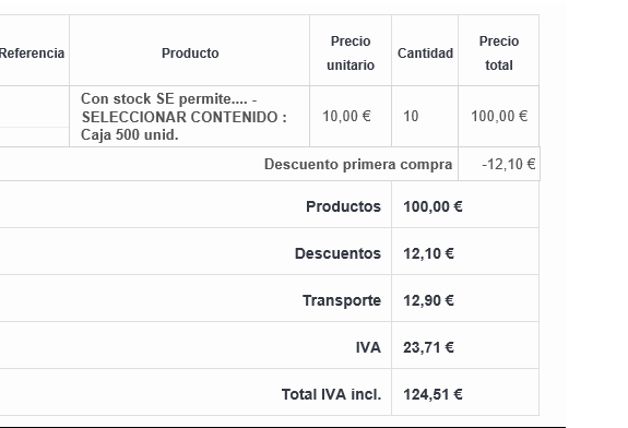

  1. Good afternoon, I hope someone can help me. When I place an order, the summary of the order is perfect. Total products without taxes Discount without taxes Transport without taxes Total Taxes Total order with taxes But the order confirmation email is not correct. The discount comes with taxes and Total taxes is also incorrect. What do I have to modify? I attach two screens so that you can see the problem. Thanks for your help. Antonio.
  2. Lo he solucionado por mi mismo. En el archivo html de confirmacion de pedido, he cambiado {total_shipping} por {total_shipping_tax_excl}
