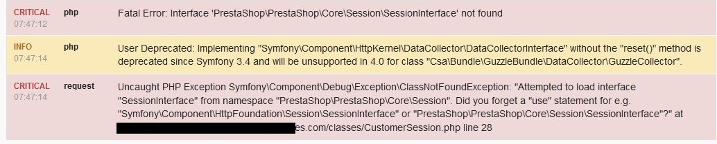

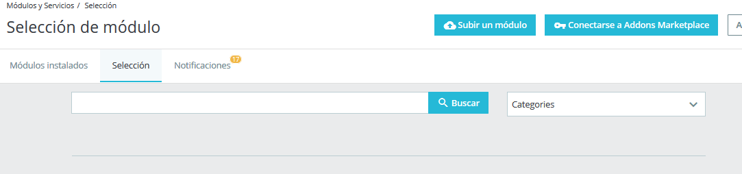

    Chile
PrestaCl's Achievements
Newbie

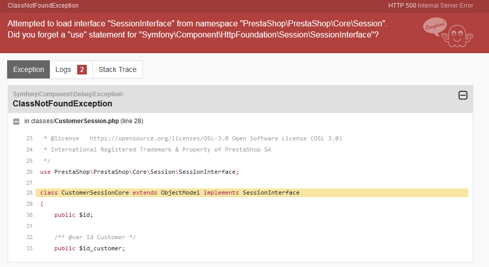

  2. Hello, well it was a long time ago that I had this problem that fortunately I could solve. Unfortunately I don't exactly remember the solution because I tried many things. But what I can tell you is that checking in my folders I have Core \ Session \ SessionInterface (my version of prestashop should not have it) Possibly I ended up copying it myself (sorry I couldn't tell but you could give it a try if you're really desperate) https://github.com/PrestaShop/PrestaShop/tree/1.7.6.7/src/Core/Session Before making any changes, do not forget to make a Backup and I highly recommend trying the modifications before in a clone store. I hope they can solve this problem soon. Greetings!

  10. Hello, i'm having this issue in prestashop is 1.7.4.2. Few days ago i tried updated my store to 1.7.6 but i had some bugs that made me use a backup from my hosting to restore to 1.7.4.2 again. From that moment i started to have problem, first with the store caché that i fixed by removing Link List Module, but now i have this new issue [ Interface 'PrestaShop\PrestaShop\Core\Session\SessionInterface' not found.] and i can´t access to the menu Preferences. I would appreciate any help
