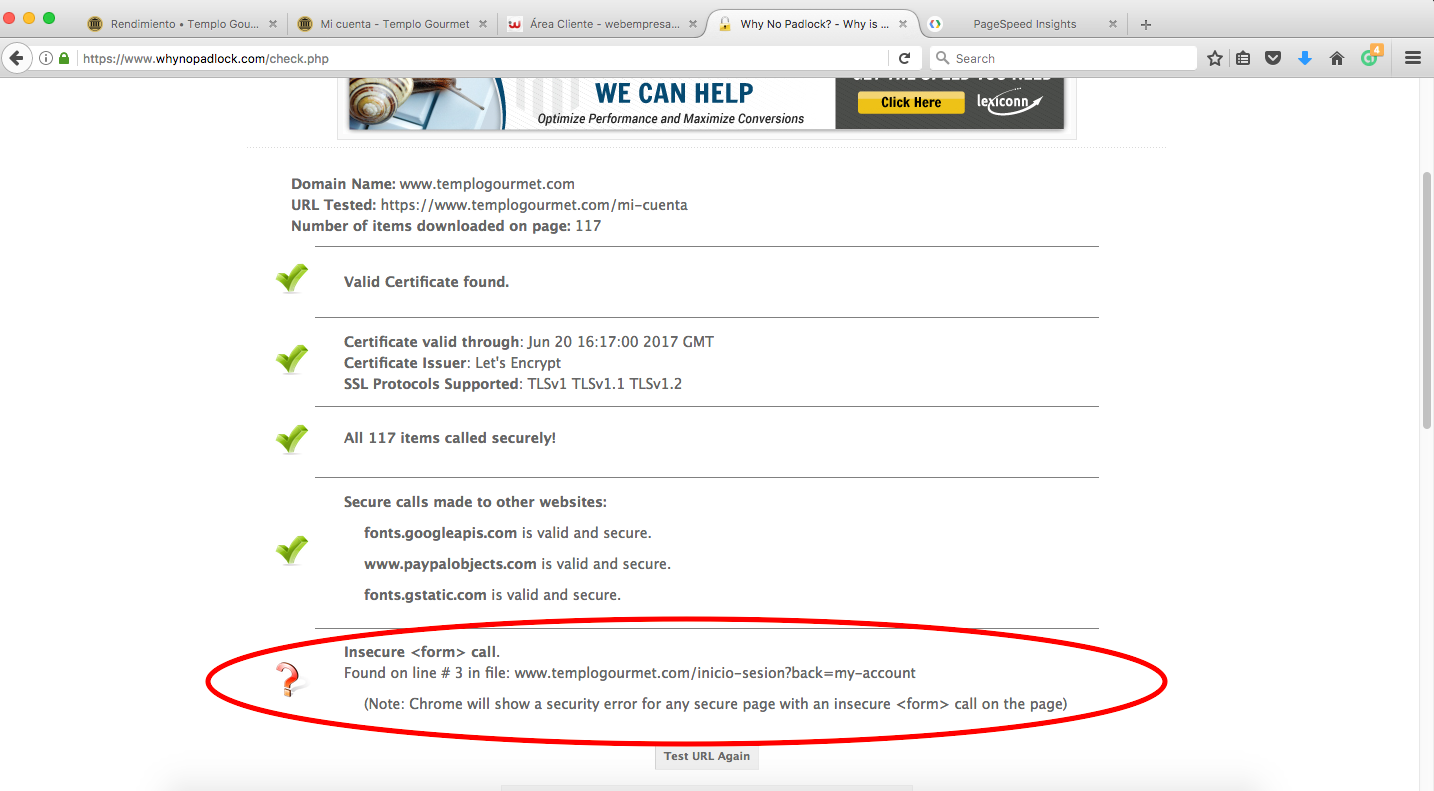

  1. Hey!, I installed a SSL certificate provided by my hosting and everything works great in Firefox (green padlock appears on the bar). However, it does not work properly on Chrome. I checked the problem with whynotpadlock.com and the it gives the following error: Insecure <form> call. Found on line # 3 in file: www.templogourmet.com/inicio-sesion?back+my-account You can see it on the image attached. Could you please help me to sort this out? (The shop is under maintenance, if you need me to activate, please let me know). Thank you.
  2. Hola, Ayer instalé un certificado SSL que mi hosting me ha proporcionado, todo funciona a la perfección en Firefox, el candadito verde sale en toda la tienda. Sin embargo, no ocurre lo mismo en Chrome. He ido a whynotpadlock.com y he hecho el análisis obteniendo este resultado: Insecure <form> call. Podéis ver más detalles en la imagen adjunta. Podríais darme alguna pista de como solucionarlo? (La tienda está aun en mantenimiento, si necesitais que la active decidmelo. Gracias!
  3. Hola, Finalmente he podido solucionar el tema actualizando a PHP 7. Podría algún moderador cerrar el tema? Gracias!
  4. Hello, I have sorted it out by upgrading to PHP 7. Could anyone close this topic? Thank you!

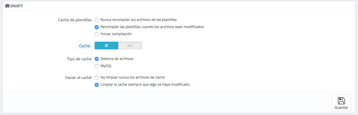

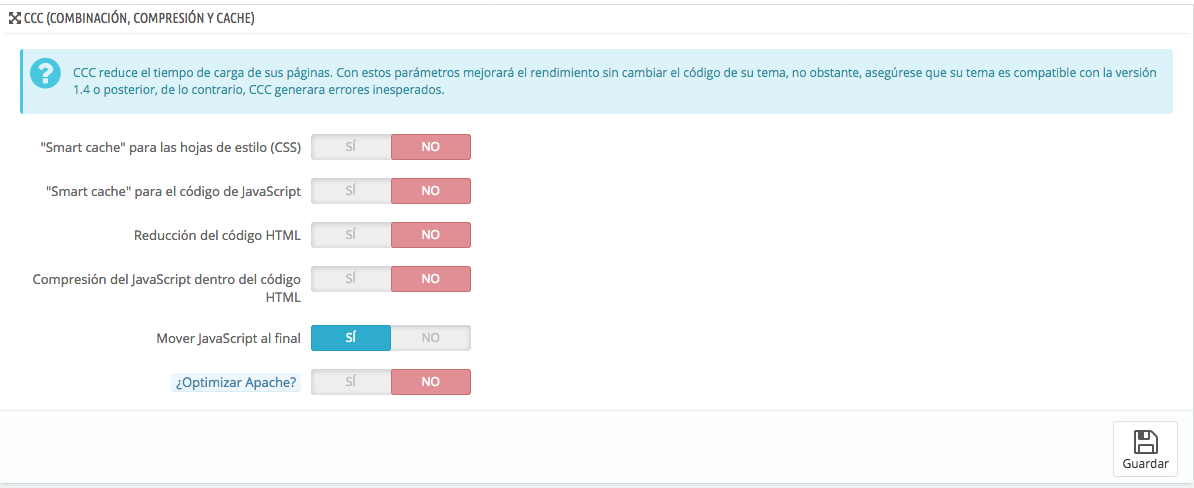

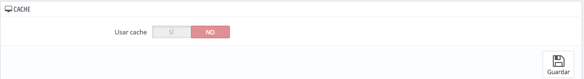

  5. Hey there, I have recently found a problem while trying to save an exception for any module position. After adding the pages in which I do not want the module to appear, I click on Save. Everything seems to be ok but there is not any change in the front page and when I enter again to the module exceptions, I do not see included the ones that I added previously. I have been looking for a solution of this problem but I have not found anything in order to get this problem solved. It is weird because few weeks ago I saved properly some exceptions. I attach few screenshots of my current cache configuration (the shop is still being created). Hopefully you can help me, thanks!
  6. Subo el tema a ver si alguien más me puede echar un cable. Gracias!
  7. Hola Sergio, Tengo PS 1.6.1.11. Me pasa con todos los módulos, he probado con varios y ocurre lo mismo con todos. En cuanto a la cache, adjunto pantallazos de como lo tengo, todavía estoy desarrollando la tienda por lo que no está configurado como si estuviera live. Acabo de activar el debug y no sale ningún error al guardar excepción. Muchas gracias!
  8. Hola foreros, Hace una semana llevo buscando la solución a este problema pero no he hayado ningún post al respecto. Resulta que cuando voy a Excepciones de posición de módulos, añado las páginas en la que no quiero que salga el módulo y le doy en Guardar. Todo parece correcto, pero no ocurre nada en el front page y de hecho cuando vuelvo a entrar a Excepciones veo que no se han guardado las páginas que añadí. Es muy raro porque hace varias semanas realicé unas cuantas excepciones y todo funcionaba a la perfección. Apenas he tocado ningún .tpl por lo que no sé la razón de este problema. Ojalá me podáis echar una mano, muchas gracias!

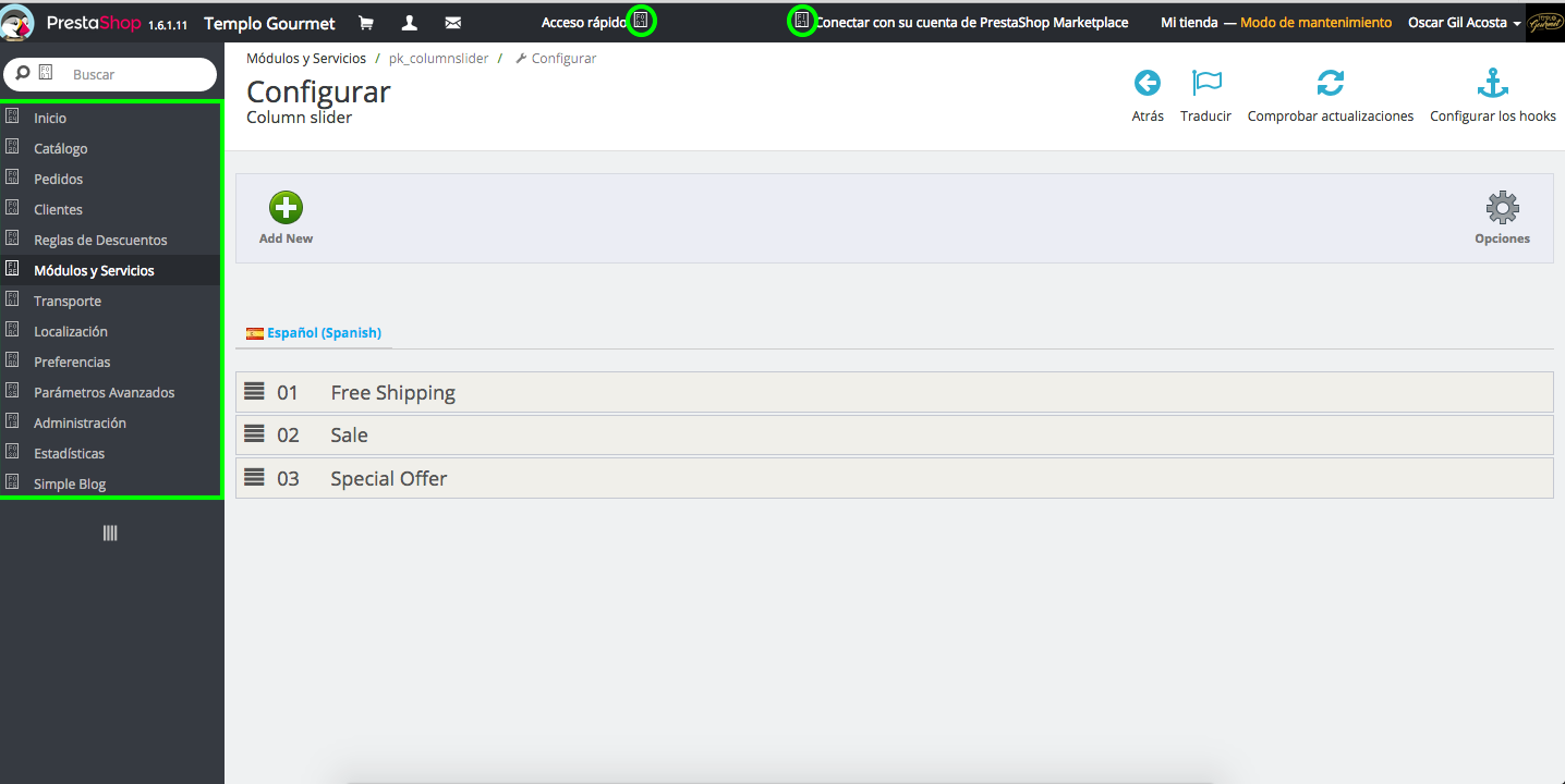

  11. Hola, He intentado usar un módulo (column slider) de un tema creado por un third-party pero en el momento de entrar en la configuración del mismo en el backend, los iconos de la izquierda del dashboard desaparecen y aparecen cuadrados con letras dentro (adjunto foto). Además, cuando intento eliminar una slide me salta un error diciendo lo siguiente: [PrestaShop] Fatal error in module file :/home/*****/public_html/*****/classes/db/DbPDO.php: Call to a member function rowCount() on boolean Además, al ejecutar análisis del servidor el asistente me da el siguiente error, imagino que estarán relacionados: PHP Fatal error: Call to a member function rowCount() on boolean in /home/*****/public_html/******/classes/db/DbPDO.php on line 208 Ya he intentado resolver el problema creando la tabla 'ps_smarty_lazy_cache', de hecho ya estaba creada cuando lo comprobé por lo que no es el fallo. Además, actualicé el PHP del servidor a la última versión y reinstalé el módulo pero el fallo sigue persistiendo. A ver si me podéis ayudar a encontrar una solución. Muchas gracias!
  12. Hi there, While using a module that I have never used before (columnslider) from a third-party template, once I am configuring it the icons of the back office disappear (I attach a screenshoot). Furthermore, when I try to delete one slide of that modulo it gives me the following error: [PrestaShop] Fatal error in module file :/home/*****/public_html/*****/classes/db/DbPDO.php: Call to a member function rowCount() on boolean I did some research and people said that it was caused because of the table 'ps_smarty_lazy_cache' did not exist but I have checked it and it does exist so I do not know what to do. I have already contacted my server provider and they say that everything is correct with them. Furthermore, I tried to reinstalling the module and everything remains the same. I hope you can help me, Thank you.
