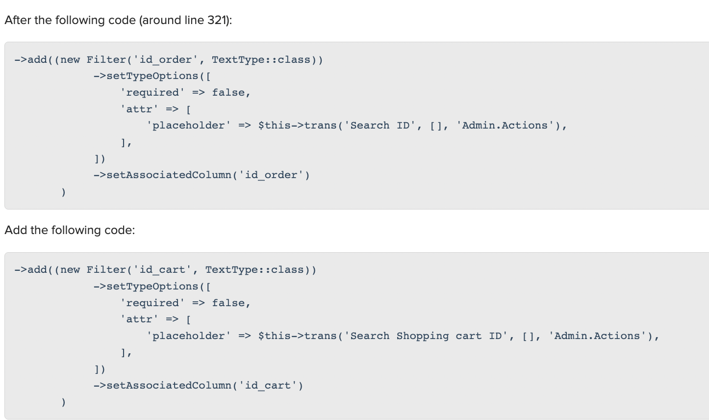

  6. https://payzen.io/de-DE/faq/how-to-manage-the-prestashop-order-id.html @Yulia Vitun check this link. if you donot get what you want. let me know. for filter, you have to update 2 more lines. visit link and change accordingly.
