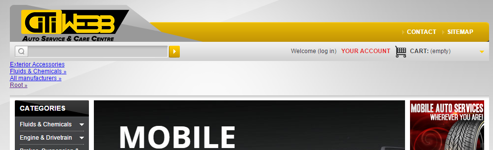

I just set up an Auto shop and everything is running great except I can't seem to add a horizontal menu to the theme I am using.
I purchased it from Template Monster and each time I activate the Top Horizontal module, a couple of links show and that's it, no bar, no nothing. You can see what I mean in the screenshot I attached.
Also it appears vertical each time versus Horizontal.
Any idea what could be wrong.

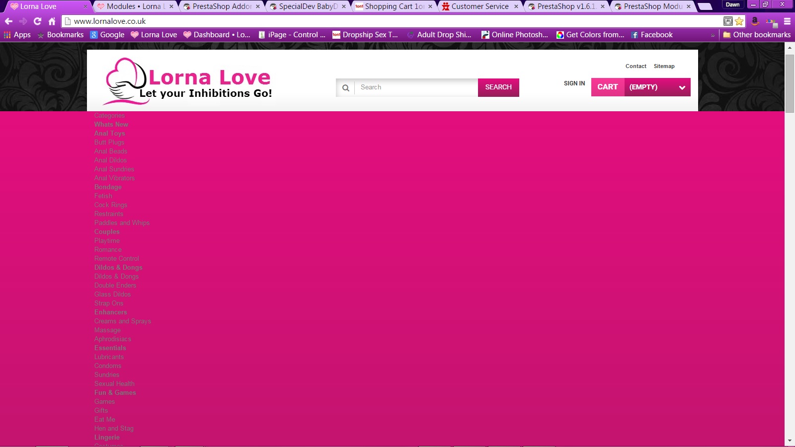

Ive been using Top horizontal menu v2.2.2 - by PrestaShop with no problem on Prestashop 1.6.0.14 but after my recent upgrade to 1.6.1 its is no longer working properly i just get a large block of pink (colour of theme) with a long list of my category's. Have attached picture.
Could anyone please help me correct this problem.
Thanks Dawn
