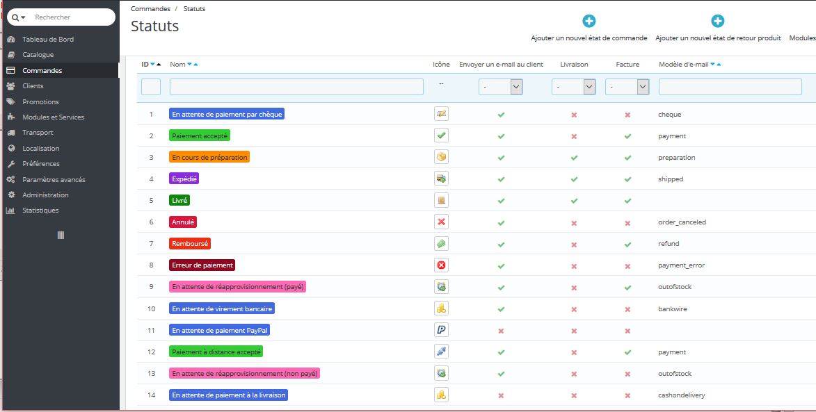

Ufasimba Posted June 14, 2016 Share Posted June 14, 2016 Hello Jayq, Thanks for answer! Now all these email notifications to customer are functionning! Great!! I would like to change the sender email...as you can see below the sender is a yahoo email address. It is the email address use to log in Back Office prestashop. How can I do? Thanks for your advice! Best regards. Link to comment Share on other sites More sharing options...
markthedoc Posted June 23, 2017 Share Posted June 23, 2017 Hello Jayq, Thanks for answer! Now all these email notifications to customer are functionning! Captureemail notofocaton activated.JPG Great!! I would like to change the sender email...as you can see below the sender is a yahoo email address. Capturemailenvoiokmaischngeexpd.JPG It is the email address use to log in Back Office prestashop. How can I do? Thanks for your advice! Best regards. I know this is an old post - apologies for replying but did you work out how to fix this Ufasimba as I have the same problem. Thanks Link to comment Share on other sites More sharing options...
