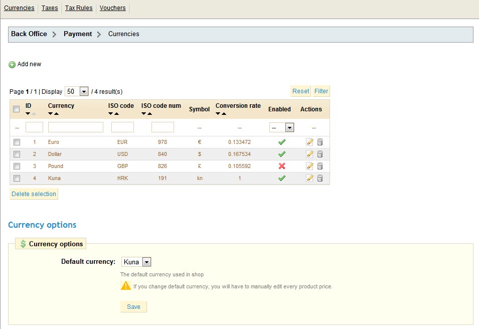

duxyz Posted August 31, 2012 Share Posted August 31, 2012 (edited) Hi, I am using Prestashop version 1.4.9. final. After upgrading Paypal module to version 3.0.11 my problems begin. Last version I had (I think 2.8.x) worked OK. My shop's default currency was Croatian Kuna (HRK), and when user has chosen Paypal as paying method, module automatically changed currency accordingly to equivalent in US dolars (Paypal paying method). Now I just get this error: Please refer to logs: PayPal response: TIMESTAMP -> 2012-08-31T18:34:26Z L_ERRORCODE0 -> 10605 L_SHORTMESSAGE0 -> Transaction refused because of an invalid argument. See additional error messages for details. L_LONGMESSAGE0 -> Currency is not supported L_SEVERITYCODE0 -> Error In attached files you can see my settings. I think they are OK? Please help me, I am searching and searching for answers but can't find any clue what to do. Do you maybe know where can I find to download older versions of Paypal module so at least I can try to install them again if there is no solution for this? Thank you very much! Edited August 31, 2012 by duxyz (see edit history) Link to comment Share on other sites More sharing options...

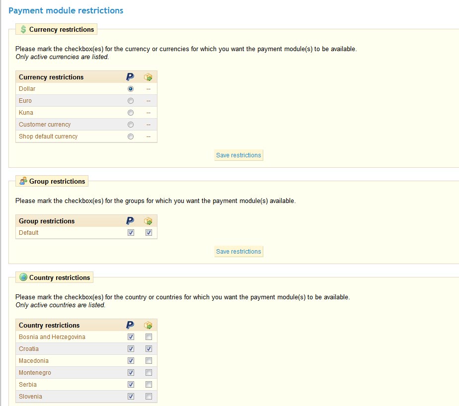

PrestaHeroes USA Posted September 1, 2012 Share Posted September 1, 2012 from back office-->payments make sure your paypal is set up to USD and not default shop currency or customer currency. Link to comment Share on other sites More sharing options...

mehnihma Posted October 12, 2012 Share Posted October 12, 2012 (edited) I have the same problem But how can I make paypal set up to USD and not default shop currency or customer currency. Because I can choose one of them bot I cannot deselect them? Help Edited October 12, 2012 by mehnihma (see edit history) Link to comment Share on other sites More sharing options...
