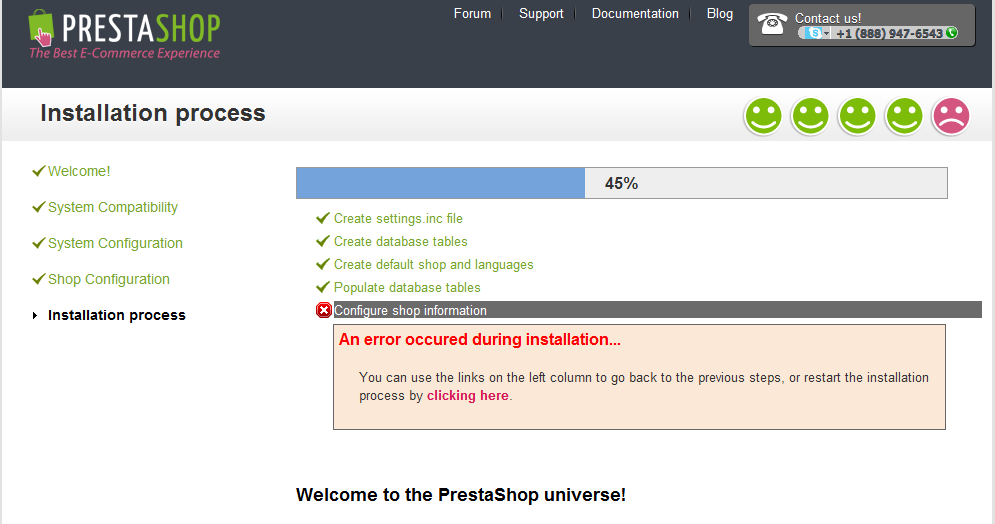

72%
  • Create settings.inc file
  • Create database tables
  • Create default shop and languages
  • Populate database tables
  • Configure shop information
  • Install modules
    • Cannot install module "homeslider"
An error occured during installation...
You can use the links on the left column to go back to the previous steps, or restart the installation process by

I'm having a similar issue to a few others on this particular topic.
Fails at 45% - Configure shop information
My version is: 1.5.0.17, I am installing on a Windows 2008 R2 Web Edition Server, I initially got an error regarding the "settings.inc" which was resolved as a permissions issue on the /config folder, following that I got an error regarding "Create default shop and languages", this was resolved again with a permissions issue with the /img folder.
These errors were picked up in the /log folder, however nothing is being reported for this particular error.
Any feedback would be gratefully received.
